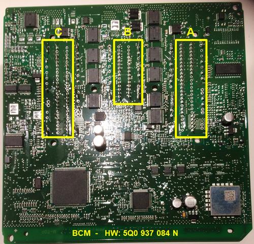

        The hex09 module is a very sophisticated piece-of-kit (see a picture of the motherboard below) and a Leuchte-set is capable of separately operating both incandescent lamps and LED lamps. The way that the hex09 module knows which lamp type is plugged into a particular lamp-base (and therefore which lamp type is connected to a particular pin on the hex09 module) is by the values coded into the 19 x channels for that Leuchte-set. This is called "Leuchte-prgramming".

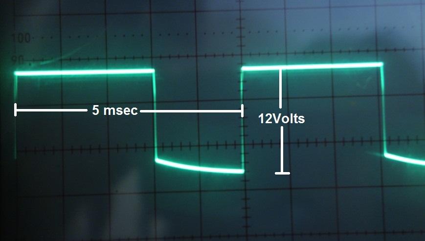

                I'm not aware of any information in the public domain about the design characteristics of the Leuchte circuits inside the hex09 module. The only information that I'm aware-of is stuff that folk like us have discovered (like my oscilloscope trace below - which shows the PWM waveform from a Leuchte-set with a LED setting of 75% illumination).
                About the best that you can do (IMHO, of course) is to source a lamp that has a LED from a reputable manufacturer. Phillips is such a manufacturer IMO. So in this regard, your second suggestion is better than the eBay LED (again, IMHO). That said, simply because the lamp has a well-made LED doesn't mean that the specs in the semiconductor junction are compatible with the design characteristics of the Leuchte circuits!!

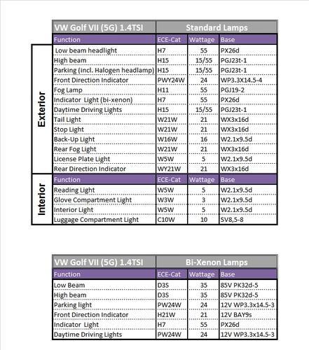

                        DAF3-AFA8-A818-49-DC-A16-D-4-B9681786-E67 — ImgBB
                        65-FD15-DB-2472-4662-A516-180-E8-C8-F8497 — ImgBB
                        What coding are these for in OBDeleven?
