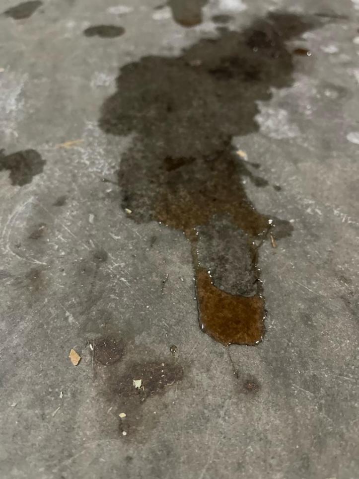

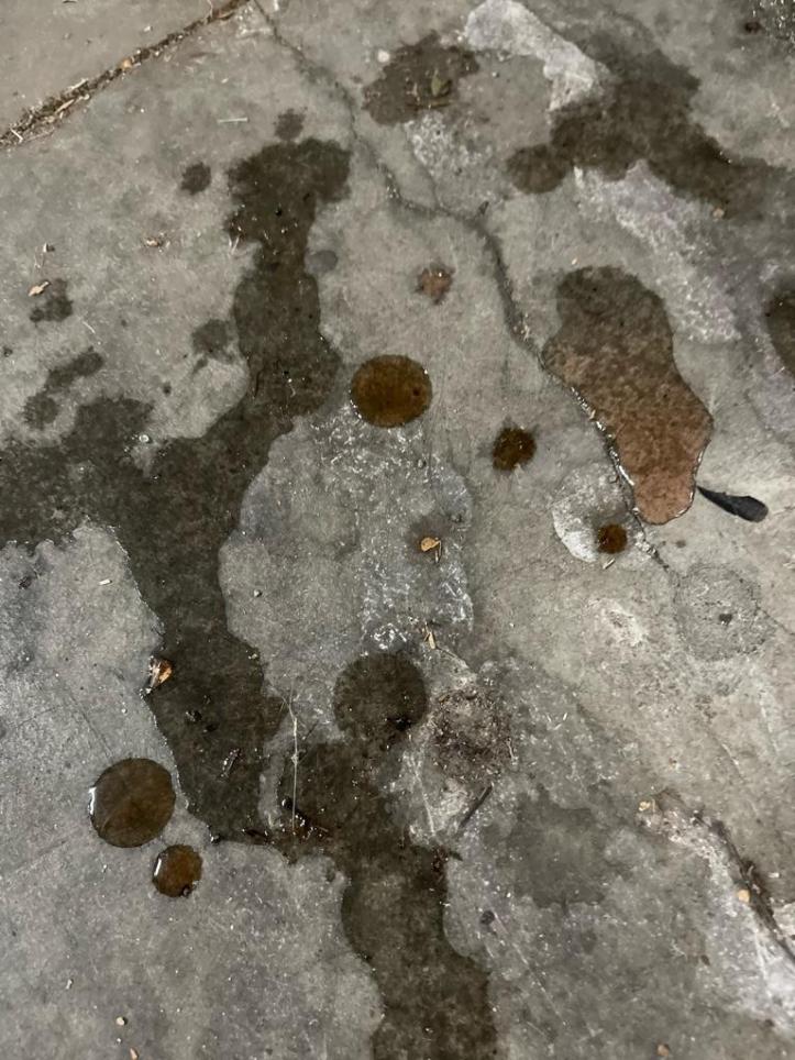

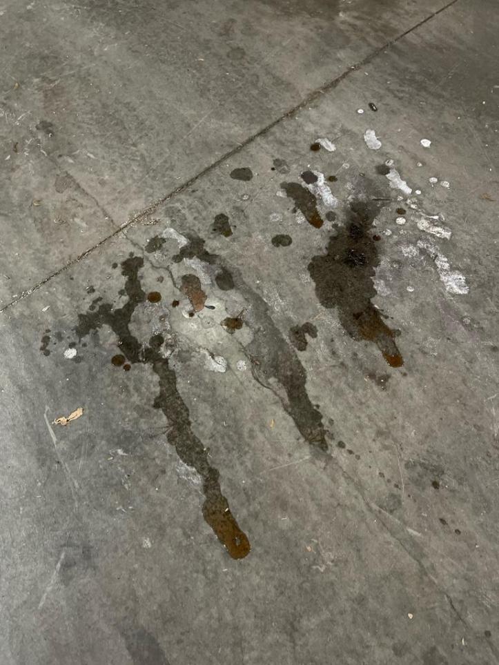

    Looks like I’ve got a pretty gnarly leak on my 2019 GTI (25km, just in 3 years).
    Guessing it’s from the coolant as the level was super low and I had the flashing warning light.
    Any thoughts/ideas?
    Booked in with VW.
    If you are lucky it might be just a plastic connector for a coolant hose (these are brittle and sometimes crack, especially the one near the turbo). Check to see where the leak is.
    But yes, usually the leak is from the thermostat housing, and most people replace the water pump while they are at it. $$$$$
