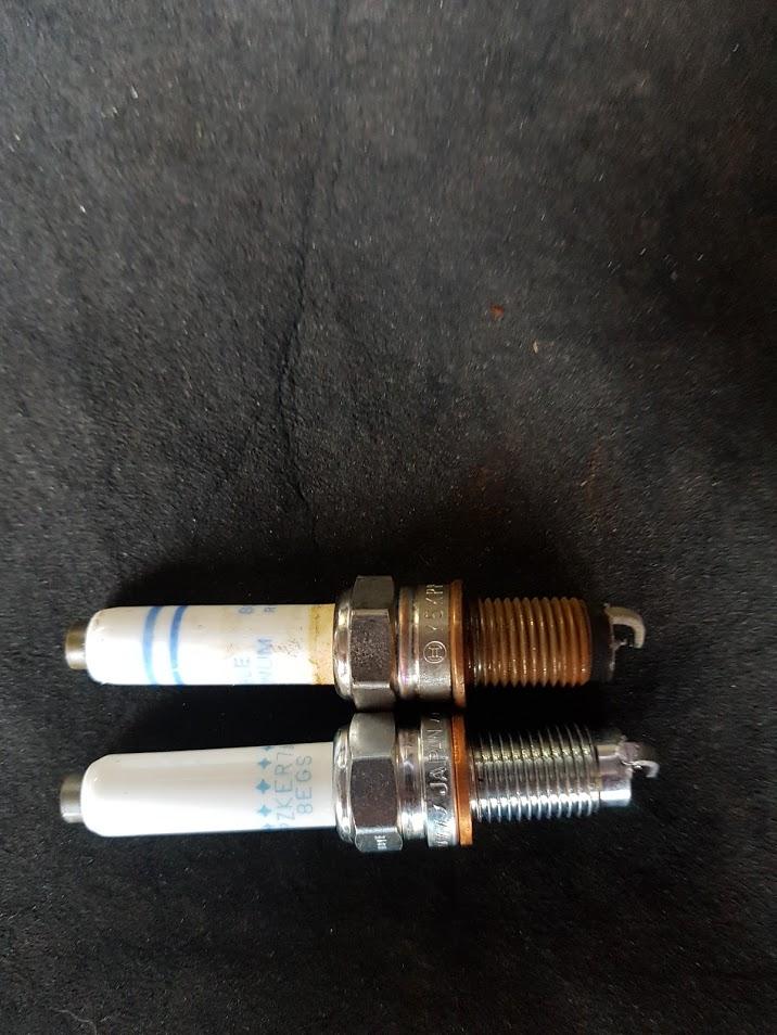

          Had another go, got 3 coil packs out this time and replaced the 4th.
          New plugs are slightly different to the old ones - at the end of the thread, they are longer:
          (new one at the bottom)
          The old ones were Bosch plugs installed by a local VW mechanic, the new ones are NGK PZKER7A8EGS.
          Thinking they might be wrong, I called up Repco and the guy cross matched the genuine VW part number and these are what came up as the replacement.
          I installed them and the car seems to run fine but can someone explain why this is, or if I am likely to cause damage?
            could it be the Bosch are wrong?
            Coil on plug are very common and personally, I've had a world of pain with traditional spark plug wires/boots over the years so I see no difference
              Well I looked up the part number on the Bosch plugs.
              Both it and the NGK part number are listed as replacements for the OEM VW number.
              No idea how that works but I'm guessing if any catastrophic damage was going to happen it would have happened already (plus there would probably be some info about it online since surely someone else has bought NGK plugs for a Golf before!)
