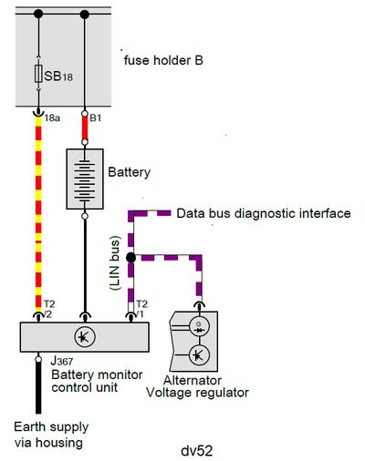

            Lucas: No offense intended, but a point of clarification regrading "the little plug on the negative terminal" technique as a solution to disabling SS.
            As I suspect that you already know, that little (2 x pin) plug ostensibly powers the Battery Monitor Control Module which VW otherwise calls J367. And you are correct - the module does indeed piggy-back onto the negative battery terminal and yes pulling the plug will disable SS.
            But (and there is always a "but") there are undesirable side effects when using this technique which can best be demonstrated by looking at my very cut-down wiring diagram for a typical MQB platform vehicle:
            As you can see - the "little plug" is the 2 x pin connector labelled T2 in my diagram. Notice that it supplies power to J367 and more important for SS technique, notice also that pin #1 on the plug is the LIN communication wire. For others reading this, LIN is an acronym for Local Interconnect Network- it's a low speed, single wire protocol used for data exchange between a LIN master module and up to 16 LIN slave control units. In this case, J367 is a LIN slave for the master module "Data bus diagnostic interface" in my diagram (also designated "J533" in the VW wiring diagrams) and the Voltage Regulator on the Alternator is another LIN slave on this local sub-system.
            So, the role of J367 is (as the name implies) to monitor the condition of Battery and as part of this function, the module reads every milli-ampere of electrical current that is either pulled from the battery as electrical load, or is injected into the battery by the alternator (or by an external charger - that's why it is essential when using a charger on cars with J367 fitted to use the special lug for the negative charger lead).
            This data stream is sent via the LIN bus to J533 and it is used to calculate the optimal charging profile from the alternator. Other battery variables are also fed into this calculation like the manufacture type of the battery and the rated battery capacity (both of these variables are set in the adaptation channels in J533). In addition, there are other changing variables sent over the LIN bus such as prevailing battery voltage and battery temperature (which is calculated using a map and the ambient temperature).
            As stated in VW's Self Study Program on SS: "the data obtained allows the charge regulation as well as the charge voltage to be adapted to the charge and operating state of the battery" at any point in time over the battery life cycle.
            Of course, if the "little plug" is disconnected - none of these calculations are possible because the LIN bus is severed and because J367 is disabled. This means (I suspect) that the process for maximizing battery longevity (which is optimized via the alternator charging profile) can not happen.
            Now, I hate SS (like you) - but I'm not sure that I would want to interfere with the monitoring and optimization of the battery over it's full life cycle! Far better to defeat SS with a diagnostic cable, or even better to install an auto SS kill switch IMHO. Or, said another way- don't disconnect the "little plug"!!

              Don - no offence taken, and I wont argue with your electrical knowledge on these vehicles as you are in another league compared to myself and im sure I can speak on behalf of others on this forum in saying you are most likely in another league compared to most people. I am good with mechanical repairs and modifications, but electrical stuff has never been a strong point for me.
              To clarify, have disabled the SS system in both my VAG cars via my Carista dongle/app combo, but I have heard of other people on here using the method of unplugging the connector on the battery on MQB cars - so I was simply trying to give the original poster a quick and free method (although I must admit I wasn't aware of the detail you went into, and knowing this now, it's not something I would recommend).
