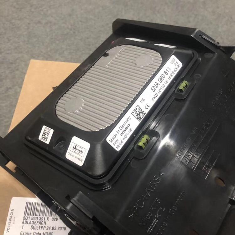

      What I'm looking at is this: For VW Golf 7 GTI R Installation Wireless Charging Module Package 5NA 980 611|Fuses| - AliExpress
      It appears to be an original LHD cubby with factory wireless charging.

        As an alternative and with the caveat that I have never installed one of these modules - it looks like the active part of the module is just clipped into the bottom of the cubby housing - see the tabs in the picture below from your link:
        If this is the case, then perhaps a "less-courageous" option is buy a 2nd-hand cubby from another RHD car (wrecker purchase) and modify the attachment arrangement? Even if you have to plastic-weld the module enclosure to the RHD cubby, all the work is done on the underside of the cubby - so it's not seen!! And, in the alternative that you don't have the skills required to fix the module to the bottom of the RHD housing - you have saved the price of a new LHD cubby, which can be spent on the services of a professional provider!!
