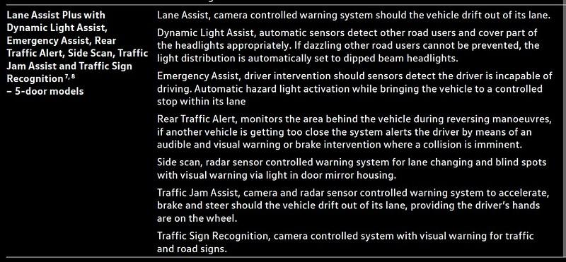

                    Hi guys, Old thread I know, but I'm confused as to what TJA actually does. OK, mines a UK car but I assume it's supposed to work the same no matter where you are. I specc'd my 2018 MK7.5 GTI DSG with the "full" safety package here in the UK (and it was an expensive option), which according to the brochure, is supposed to contain the following:
                    What I was told, this is supposed to slow the car down when approaching slow moving or traffic at standstill, and potentially bring the car to a complete stop (which it does when ACC has been enabled). However I was told that up to about 25-30mph, the car should stop, start, steer etc. automatically in reaction to the car in front. However whilst mine does stop, if it stops for long enough to cut the engine (start/stop), it needs me to blip the throttle to get it moving again - i.e. it's not automatic ?
                    Furthermore, by pressing the button at the end of the indicator stalk, all my assistance systems show up (Front Assist, Lane Assist, Side Assist, Rear Assist etc), but no mention of TJA, and nothing in any of the car menus either ?
                    Is my understanding of what TJA actually does wrong then ?

                      sootchicker: I'm not entirely convince about the description of TJA on your black page. I guess that it does work as described - but it does lots of other stuff too (see here)
                      Before Kamold replies to provide a more authoritative answer - it's possible that the need to "blip the throttle" might be because of Start Stop (which probably countermands TJA) - what happens if you switch-off SS with the disabling switch on the console?
                      The other "system" that might be responsible for your observed dynamic is Auto-Hold - which transfers the brake pressure from the foot pedal to the EPB after a few minutes. What happens if you switch-off Auto-Hold with the button next to the EPB switch?

                        "Furthermore, by pressing the button at the end of the indicator stalk, all my assistance systems show up (Front Assist, Lane Assist, Side Assist, Rear Assist etc), but no mention of TJA, and nothing in any of the car menus either ?"
                        There will be NO mention to TJA in any menu, so no need to worry that it isnt there. However all the boxes above must be ticked for it to work.
                        Re: ACC, When activated it will detect a moving vehicle up to 100 metres ahead and auto throttle brake as per other car (proximity) settings. Once you come to a standstill at the lights and there is NO movement for 3 seconds then ACC is deactivated or maybe a better word for it would be passive mode. All you need to do is tap the accelerator to continue ACC or hit the ACC speed adjustment button on the Steering wheel (left side). If you stop at lights and the car ahead moves within 3 seconds of you stopping then ACC will continue on its own. This 3 seconds can not be modified in any way and is a safety feature I believe?.
                        At 65kmh auto steering is automatically enabled and can be confirmed by the 2 green lane marking on the dash, this is NOT TJA. If you have TJA on your vehicle then these green lane marking will also be green when you activate ACC and are travelling under 65kmh. Remember that you need to be within 1 or 2 clearly marked lanes for the system to detect the lanes otherwise the lane marking on the dash will remain amber.
                        I think I have covered most of it. Not with the car now so some of the wording above will not match exact instructions. And am open for correction.
