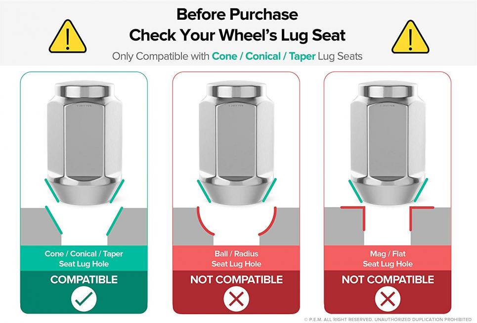

            As has been said, make sure you're running the correct bolt for the wheels. From memory, VW are usually ball seat, but OZ Racing (and many aftermarket wheels) are tapered. You should check that out if you haven't already.
            Here is a random image from google to illustrate the issue:
