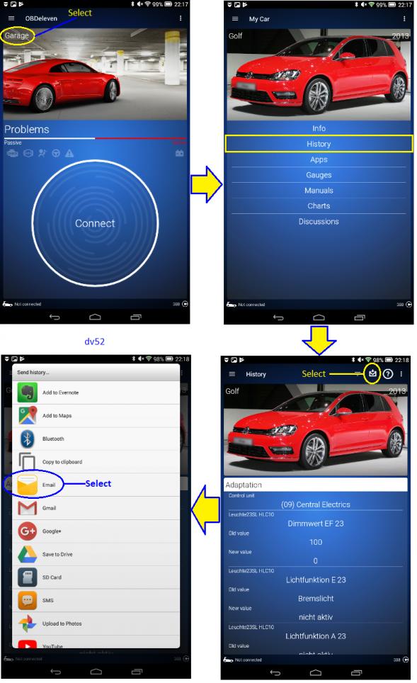

    James: Alas - the only way to "bulk-load" the original factory database for your car is by using the dealer's ODIS device.
    But it ain't all bad news because OBD11 has a history function that records ALL changes that you have made. If you access this function, you get the option to email yourself the entire file (see the instructions below). You can then look-through/print the records to identify any "aberrant" changes
