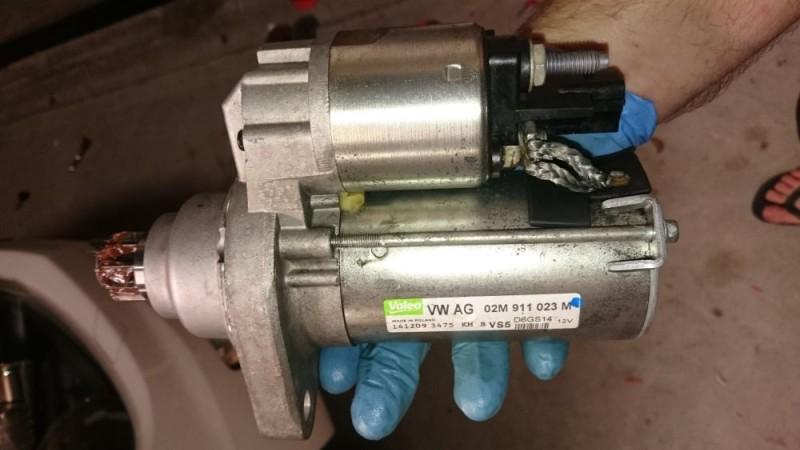

    Do you think this is a possible culprit? I jumped under the car last night to check the OEM starter motor, and its a Valeo unit with part number 02M 911 023M.
    I have just recently rung my local auto electrician who said they can source a new replacement Valeo starter motor for $450 overnight from Queensland. ECS sells them for around $400 but then you have the conversion rate plus shipping, so it makes sense to purchase locally.
    I am happy to buy a new starter motor if it gets rid of this damn engine rattle - any feedback from the mechanics on here as to whether this is realistic would be appreciated.
    Below is a photo of my starter motor. Is this the stock item? The listing on ECS shows a slightly different part number, so i assume the stater motor has been revised at some stage? 403 Forbidden

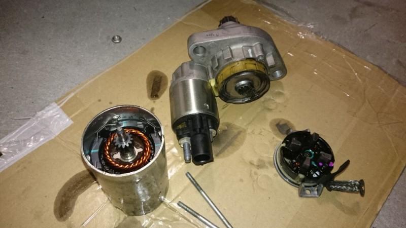

                Got home last night and was motivated to pull the starter motor off my car and give it a clean/service to see if it's the cause of the startup rattle i get about 80% of the time when the engine is cold.
                Wasn't hard to get out or disassemble. 30 mins had it removed and in pieces on my garage floor. It was pretty filthy inside (clutch dust and other crud) so i gave everything a good clean/degrease, then put a good quality Lithium grease on all the gears/pinions and put it all back together. I used a full can of degreaser on it, and got alot of gunk off. Looks brand new inside now.
                I've done 2x cold starts since and haven't had the rattle yet, but it's too early to tell whether this was the source of the noise. If i can get another week or so rattle free then i'll be happy that i have fixed the issue.
                I also took the solenoid apart and theres a piston/shaft piece in there that sits inside another piece of metal with a spring on it, so i put some grease on that too. It was clean though, so didn't need to clean that.

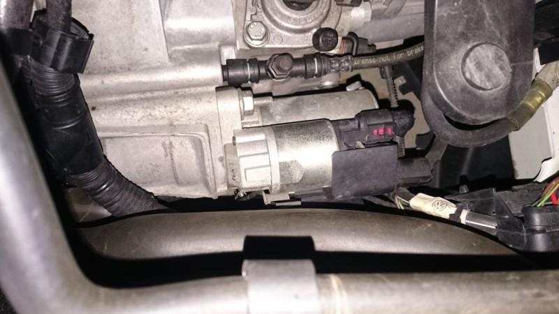

                Here it is (airbox removed for access):

                All in pieces (motor section is already clean in this pic which is why its so shiny compared to the other bits):
                One part of the internal gears after removing them and cleaning/degreasing them:
                All back together, greased up and ready to reinstall:
