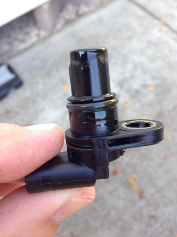

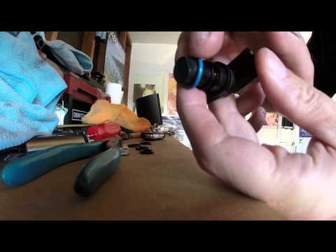

    The leak is due to oil getting past the o-ring on the camshaft position sensor at the front of the cam cover. The o-ring doesn’t seal well enough and oil works its way past it and then leaks out the front.
    You can get a new sensor from places like ECS Tuning 403 Forbidden , but seeing as the sensor itself is still working fine, and it’s just the o-ring im having issues with – I started looking into a DIY solution.

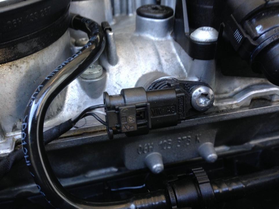

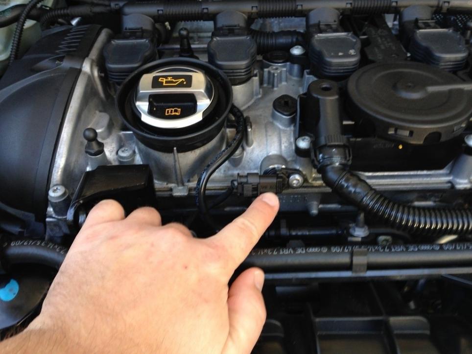

    So this is the sensor in question:
    You can see some oil residue from where it is leaking (remember i cleaned it only a few days ago so it doesn't look that bad in my photos).

    Step 1) I would suggest cleaning the oil up before removing the sensor but this is up to you
    Step 2) Get a T-30 Torx and remove the bolt holding the sensor in place.

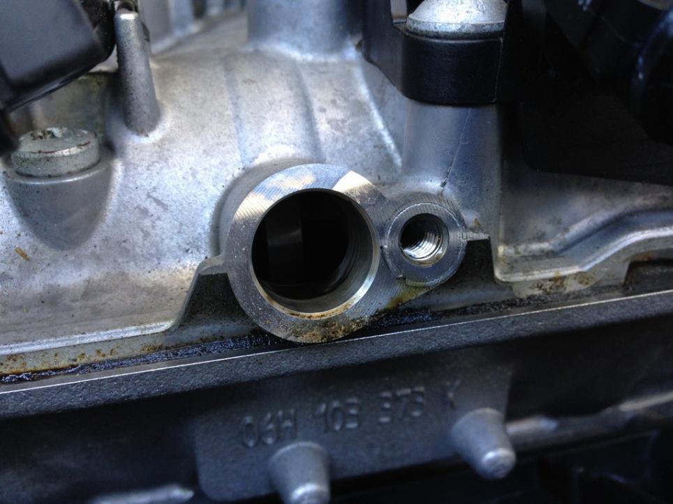

    Step 3) Clean up the sensor (use degreaser) and also the surface on the cam cover where the sensor mounts to. Make sure all oil is gone.

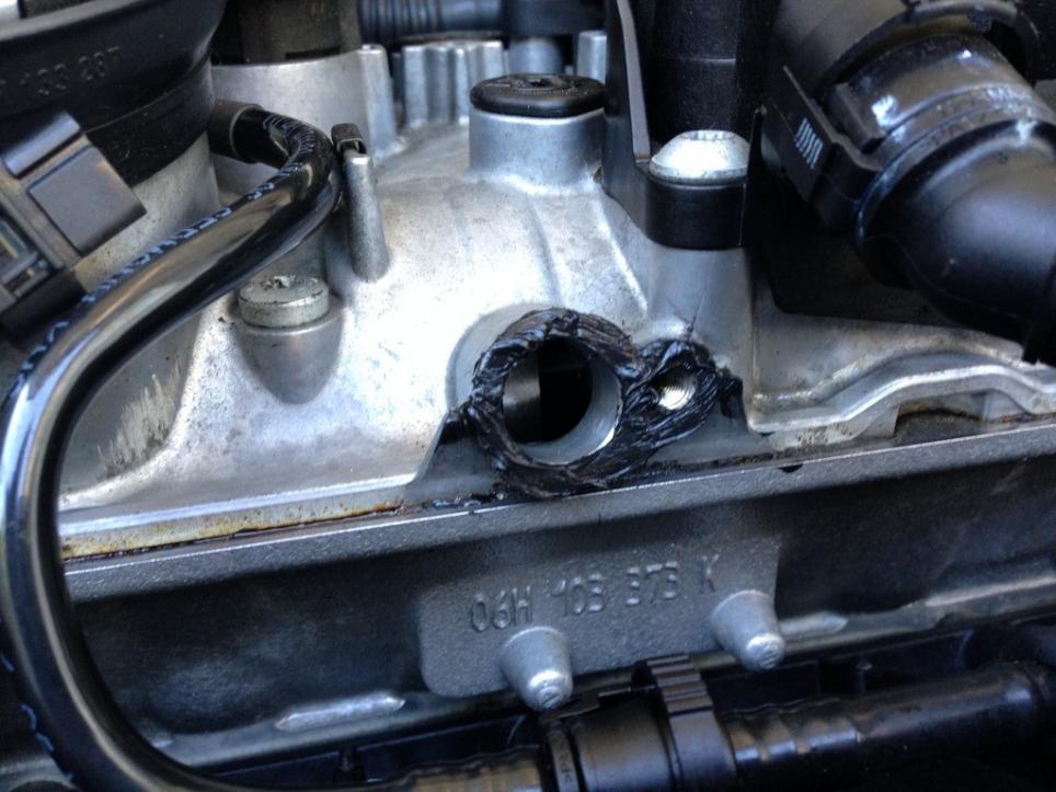

    Step 4) Apply some black (or silver) gasket sealant to the cam cover area as shown in my pics below.

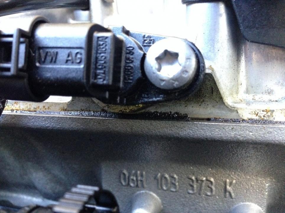

    Step 5) Re-mount the sensor and fit the bolt to secure it in place.
    This is what the sensor looks like once it has been removed
    Here you can see i have applied some black gasket sealant to the cam cover area where the sensor bolts to the engine.
    And this is the finished result. Clean off any mess with a rag and you are good to go. No more oil leaks.
