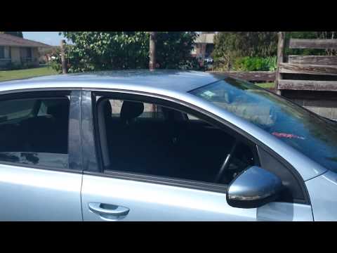

Then I was convinced to get the windows tinted by my fiancé Matt.
It's looking super bad ass now with the 35% tint.

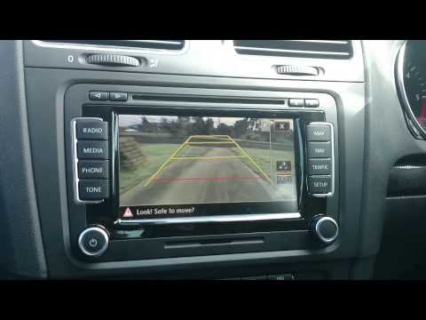

Next was the highline RVC which shows it working with guidance lines and no calibration done.
