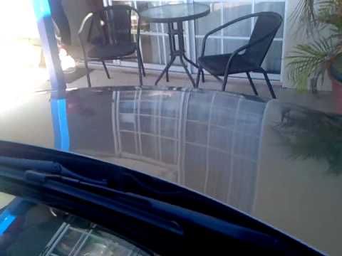

    I started the car from standing outside at one of the many motels we stayed in along the way one morning, and noticed the ticking is even louder. Like a clattery lifter sound. So next morning I got a video so I could show them when i got back to Sydney ( along with one of the two speakers they replaced still being stuffed)
    It is really noticeable and can listen in the video below.
    Has anyone else had this problem?

      These TSI engines are fairly 'clattery' for the first few seconds after startup. I noticed that your recording finished shortly after starting. How long does the noise persist for?

        That doesn't sound unusually rattley to me, though it's hard to tell from the video. I haven't listened to mine from a cold start from outside the car so can't say whether it's the same or not. It's absolutely nothing compared to the rough idle that the Ford Focus engine has when it's cold, though.

          Put it this way, it sounds like the lifters on my old 25 year old cressida. Never sounded like this before.
          It dies off just before the video ends. Theres no oil in the top end on start up. Foreman said it not right, but they don't know whats wrong and have to send the video to VW.

                  lol sounds like a diesel to me. Sure its not an Isuzu 400 motor in there?

                    The noise I experience is identical to that posted by Stoney, a 5 sec rattle on every cold start.
