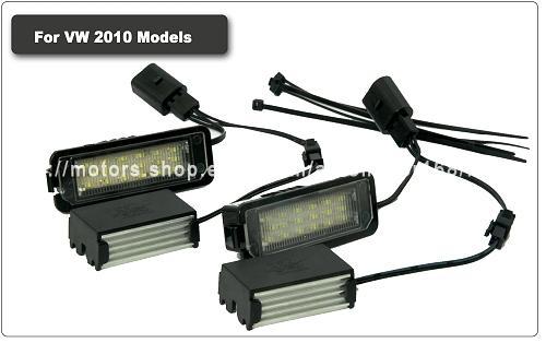

          • OK... so, i've tried to track some of this back...
            It seems in the past two weeks, about six of us have installed the lights,
            Corey, DreamensioN and myself have lights that interfere with AM reception.
            Shakespeare, markwid, Brendan_A and Vaku all have the lights fitted and do not interfere!
            Hmmm... so I was thinking it might be a batch number thing, except DreamensioN's lights arrived at the same time that markwid and Shakespere's.
            I thought it might be a GTI and R thing... but it works / not works across both cars. Thought it might be an LED Tail thing... but, again, can't seem to find a common issue there...
            So... basically, I have NO IDEA!!!
            I'd love to know the reason for it... and if there is a fix!

                  Could it be the installation method? How many followed Corey's tip of using double-sided tape and how many "just dangled" the resistor?
                  MY11.5 Golf R - Candy White 5 door - still giggling like a child when I drive it!
                  • Originally posted by orkers View Post
                    Could very well be - if the resistor is "aimed" at the rear windows, it could be generating the interference. Mine is sitting vertical, aimed outwards of the car.

                      • Originally posted by markwid View Post
                        Define which surface you consider to be the "front" though and therefore which way it is aiming?
                        If you define the "back" as the black plastic section facing up in that photo, and therefore the "front" as the opposite side to the back (lol), then mine are facing down (just like that photo) and therefore aimed away from the rear window.
                        I take it that you have the black plastic facing the front of the car and therefore the "front" aimed out the back.
                        I could certainly try that orientation - but if someone else who hasn't already taped them in could test these two orientations and report back, I'd appreciate that
