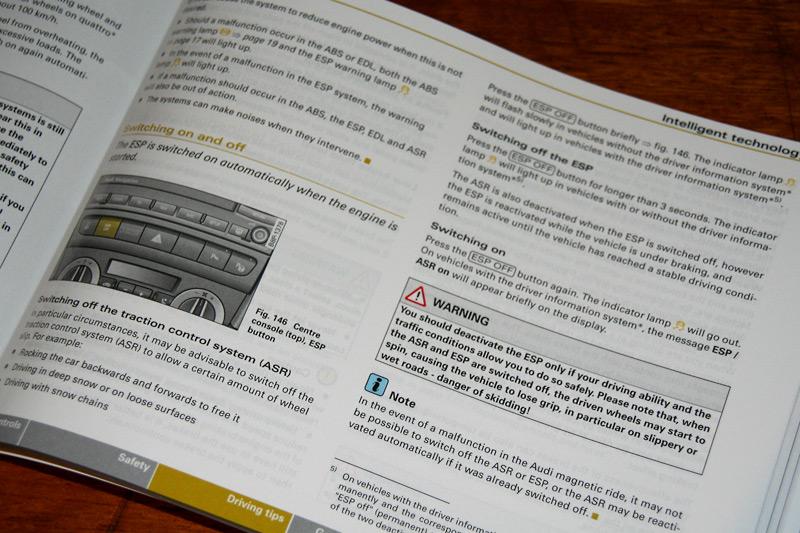

        This is the quote from the Autocar article:
        The system will only cut back in should the driver press the brake pedal in the middle of an ‘emergency’, be it if control of the vehicle is lost by the driver or if they want the car to straighten up by itself. If the brake pedal is not depressed by the driver the ESP system will remain inactive.
        It sounds like the same system employed on the MY10 S3s and beyond (it may have been introduced on MY09 models come to think of it). Here's the page from my manual:
        (apologies the focus isn't great)
        MY10 S3 3dr
