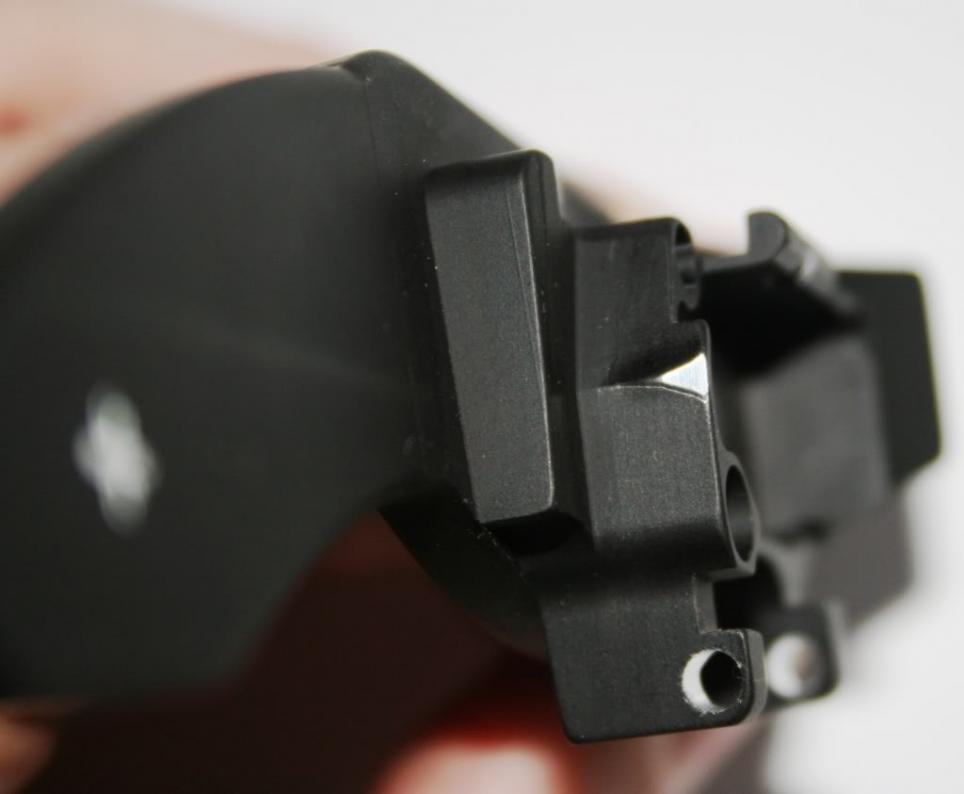

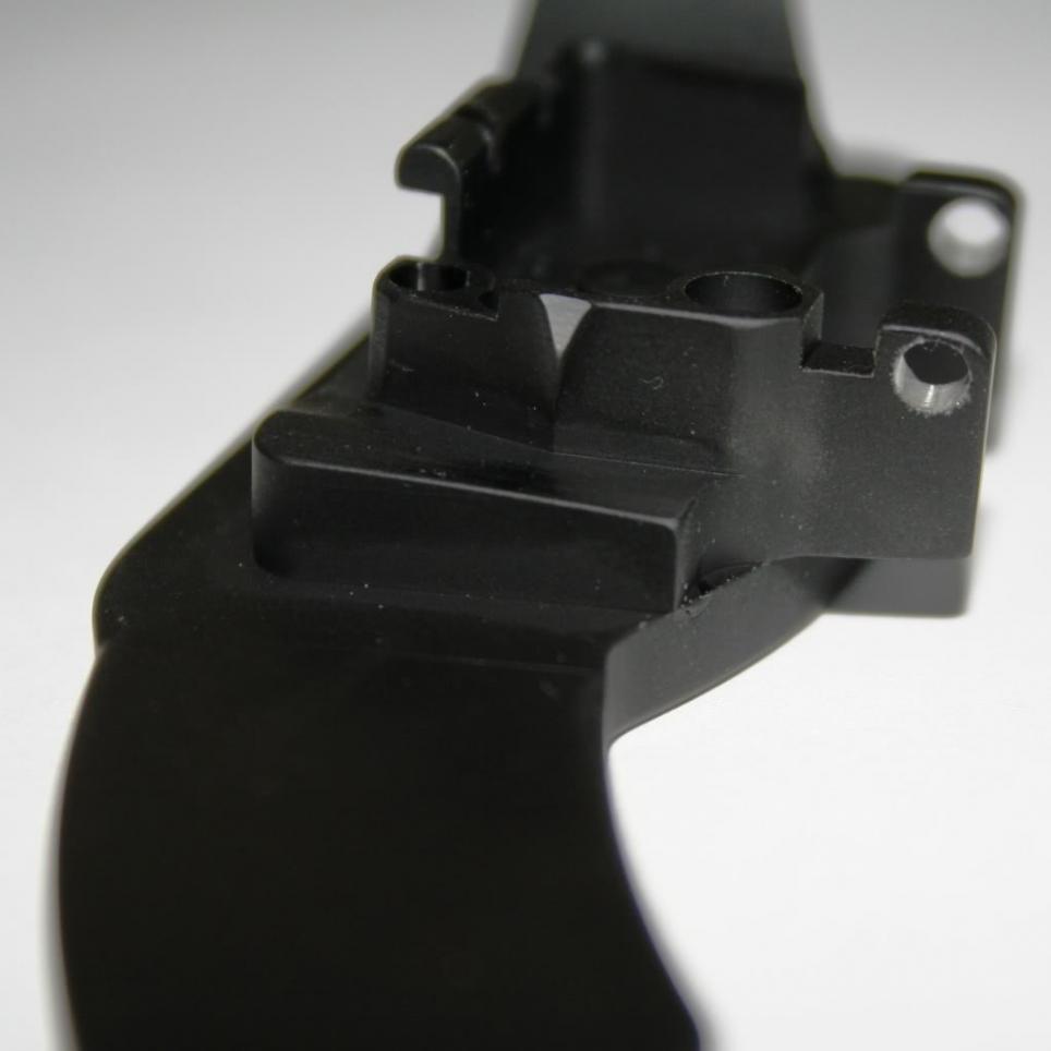

                    Okay here is the reply from Michael @ S2T
                    "I test fitted four dozen sets here at the shop and I found a few that had the issue that you have described. I am sure that your 'sticky' Paddle received too much Anodizing which has resulted in a build-up of material on the inside of the pin holes and on the outside of the base of the Paddle.
                    If you feel comfortable with a small modification of the Paddle, you can remove the Anodizing at the point of contact which should free the Paddle from touching the inside of the Paddle Shifter Module. Please see the attached pictures. To clear the inside of the pin hole, roll-up a small portion of sandpaper and twist, push, and pull it in the hole enough times to clear the excess material. This should fix your issue.
                    We very sorry and are extremely embarrassed that you have had this issue with your Paddles."
                    Also below the pics of the modifications. Sorry about the size of the photos but i wanted to keep them as high res as possible!
                    Happy to email them directly to anyone who requests it.
                    I already did the mod on mine using a dremel with a light 400 sandpaper head came out perfect, will try to fit it tomorrow and re-post.
                    Pat

                      Shows how well machined they are... you really can't tell that from most pics

                        • #72
