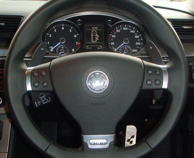

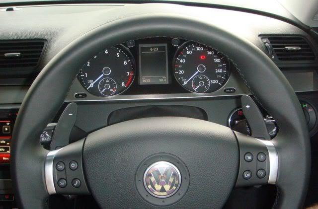

                Put mine on yesterday and really had no issues at all. A couple of fiddly bits but nothing too hard. Really only took about 30 minutes.
                Just make sure you leave the key in the ignition when you disconnect the battery otherwise you won't be able to turn the wheel!!
                Would be happy to help anyone put theirs on if they were worried about it (if they were prepared to come to my place!!!).
                Have used them every time I have been in the car since and probably will from now on given how much better they are to use.
                Photos below:

                  That looks really nice Deano! Just give the steering wheel that extra aggressive edge it needed from the outset.

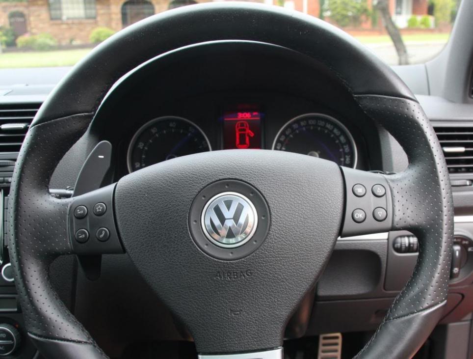

                              Right finally got around to installing them today! Nice and straight forward install which took all of about 30 minutes to do.
                              Took a picture of with and without the shifter extensions. Makes a huge difference!
                              Also as some members had previously mentioned, it would definately come in handy to have a stronger spring in place, it seems when the shifter retracts, it doesnt do so the same as the OEM shifters, although expected since the S2T paddles are a lot larger and heavier.
                              Only time will tell at this stage!
                              Keep posting pics of your installs peeps!
                                I felt this at the time of install too, but that's the last time it bothered me... I don't think about it when driving and using them and there's certainly enough spring in the stock springs that they'll work fine
