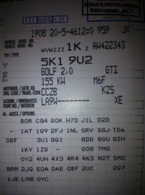

  • Originally posted by dArK5HaD0w View Post
    can some tell me what variant of the EA888 engine the Mk6 GTi has? CCTA, CBFA, CCZA, or CAWB?
    its normally shown on the build plate, or in the boot with the option codes sticker.
    CCZB mate for my manual MY10 GTI (Eng/Trans Code)
