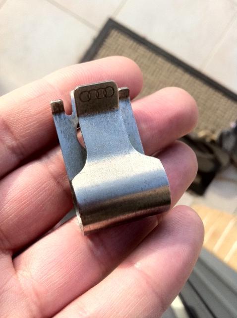

                              • got mine, huge box... smallest clip ever... lol
                                I just now hope that VW will install during next service (due soon) and thus be covered under warranty.
                                Im guessing they will refuse, lets hope not.
