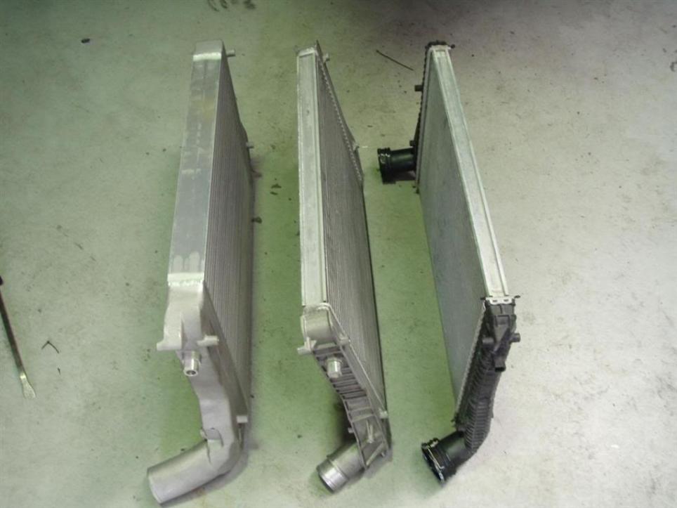

                        • Hey triode12, I've heard as well that the Pirelli's IC was larger than the GTI too.
                          But it is 100% true about the Golf GTI and R having the same intercooler. Here are some pictures. I hope Guy_H has no issue with me borrowing his photos!
                          This is from the "build photos" of Guy's Stage III S3 a few years back:
                          You can see the APR Intercooler on the left, the S3's in the middle, and the GTI's on the right.
                          And this is from the build photos of Guy's Stage III R.
                          You can see the APR Intercooler next to the R's intercooler. You can clearly see that the R's thickness and end caps are identical to the GTI.
                          • Originally posted by Corey_R View Post
                            You can see the APR Intercooler on the right, the S3's in the middle, and the GTI's on the right.
                            APR on the left you mean? And to me, that S3 item looks a "touch" wider than the GTI on the left? Might be the angle of the photo?
                            • Originally posted by dave- View Post
                              *doh*
                              Thanks, fixed that up.
                              Yep - the S3 intercooler is definitely wider than the Golf R/GTI intercooler.
                              This is why some people used to upgrade their GTI's to the S3 intercooler as a cheap alternative to the aftermarket products.
                              But back to the original point of all this. Whilst I've heard good things about the Forge twin-cooler, since the Golf R's IC is not the same or as capable as the S3 IC, to me it makes more sense to address that deficiency first before adding 2nd intercoolers.
