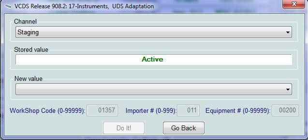

        OK, i just tried it, the setting is there in the adaption menu, i set it to active but its not doing the sweep thing.
        My car is a week 51 2009 build.

                OK, I got it, double checked everything, turns out i had to do the following to get it to work.
                Change the setting.
                Close Vag-Com software
                Unplug cable
                remove key from ignition
                lock car
                unlock car
                key in ignition
                turn on car.
                sweepy goodness.
                It looks like clusters 5K6 920 870 D and 5K6 920 970 H will activate. I have the latter in mine.

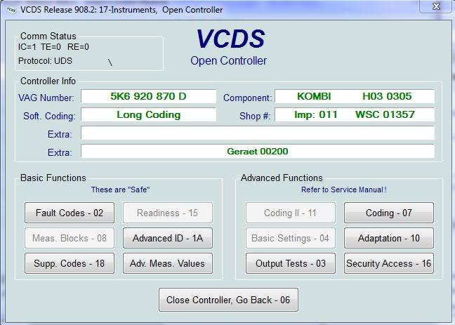

                    Instructions are in that post i linked to.
                    Basically go to the Instruments Section (17) There you should see under Controller info VAG Number...
                    Then Click on Adaptation and drop down to "Staging"
                    Set Staging to "Active" and click Do It!
                    Its a 2 minute job if u know where to look.
