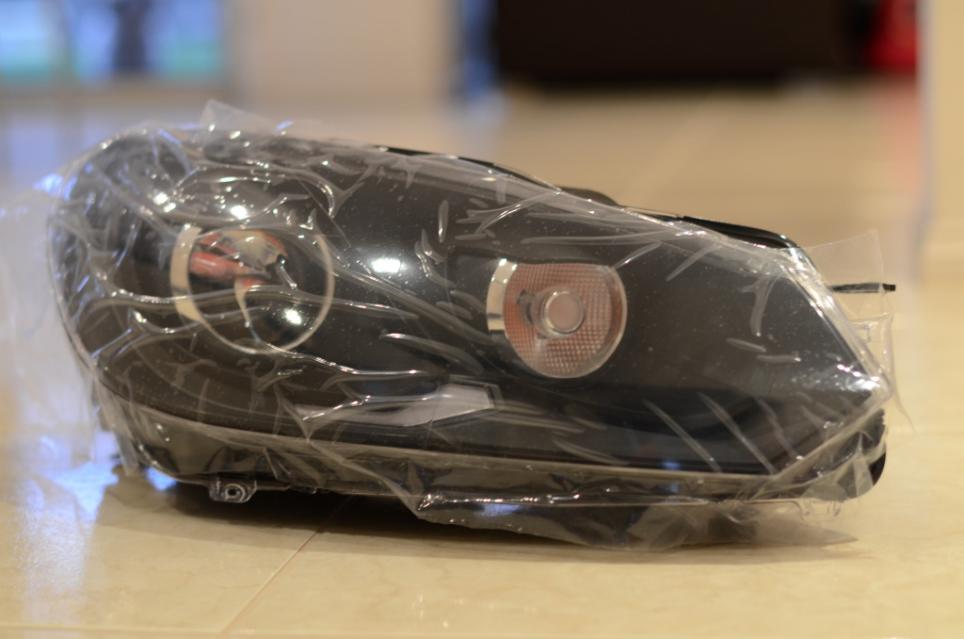

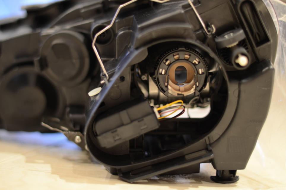

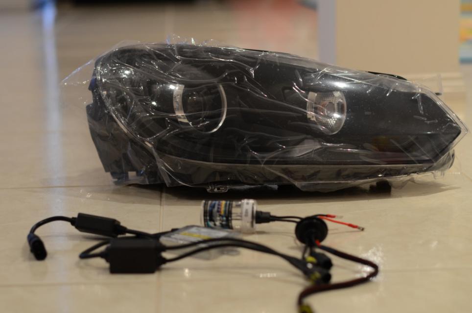

                      My initial plan was to go OEM R20 headlights however after many unanswered emails to various German suppliers and to-ing and fro-ing (with the one or two who did respond) trying to confirm CECM part numbers etc etc, it became very frustrating and after 2 months I gave up on this project. Fortunately a friend of mine recently came back from overseas and was kind enough to bring over a set of R20 Replica HID Headlights which ended up being much cheaper than the +$2k i was going to spend on OEM.
                      My first impression was 'WOW, i was not expecting this high level of quality'. The finish was good, plastics was good and assembly was flawless. I even tried shaking it to see if there were rattles inside,.. nothing.
                      I also ordered a set of 5k HID lights with ballasts

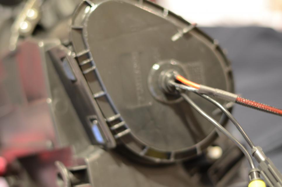

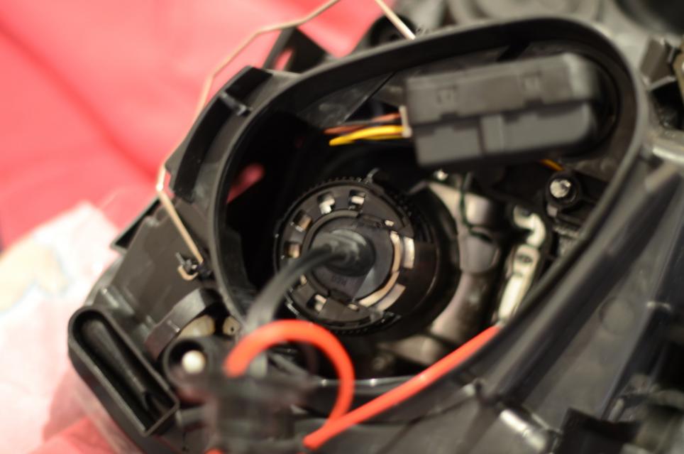

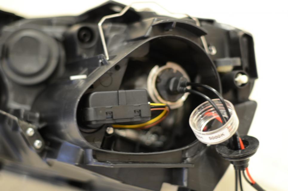

                      What was really great was the headlight housing is prepped up for HID meaning no cutting or splicing of the wires required, just take your HID lights and plug straight into the housing.

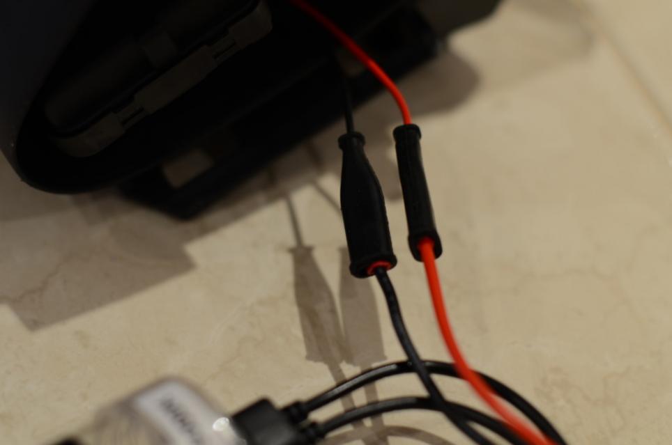

                      Red and black wires direct plug & play
                      With the HID lights plugged in
                      It gets sealed up nicely with a rubber grommet. Waterproof so no condensation....

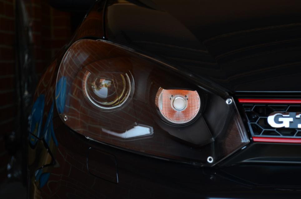

                      M4RKO has a brilliant write up on how to retofit headlights, the DIY is detailed and with plenty of pics. Follow it step by step and you can't go wrong, thanks mate your a life saver!!!!

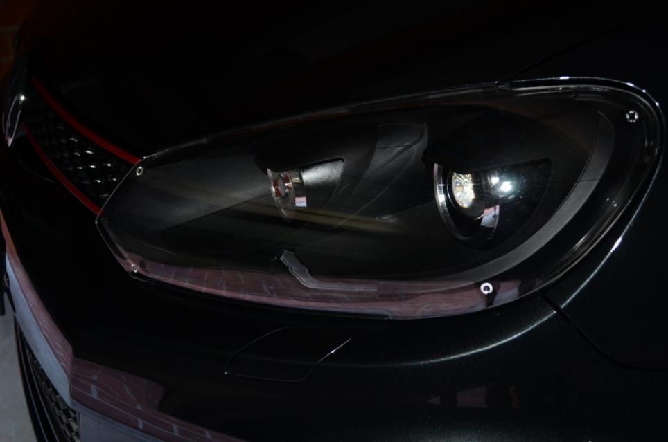

                      The finished product,.. (I only realised when posting up the pics I have the VW headlight protector on, should have removed before taking the photos)

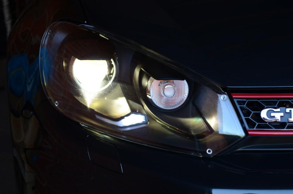

                      The white light you see under the low beam is an LED which acts as your DRL.

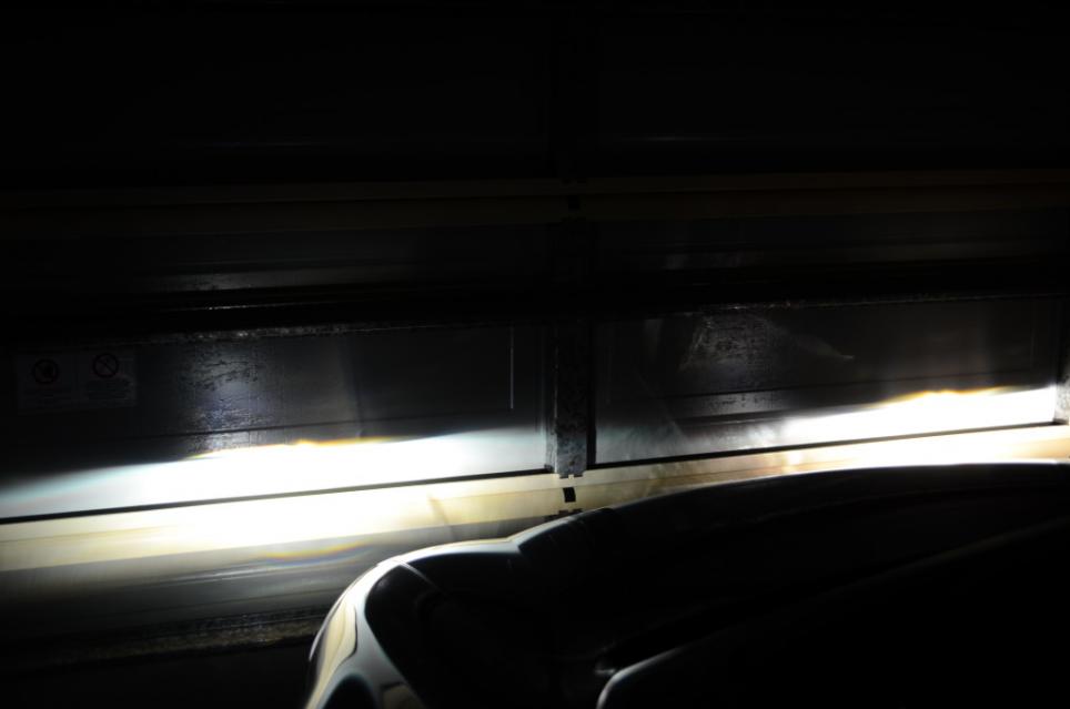

                      ...and the light projection is great, a clean cut-off. Btw you can still use the leveller inside the car to adjust vertically.
