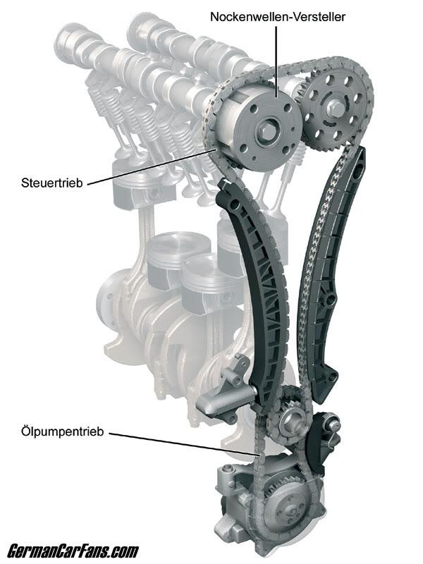

          • Hi All,
            I have had a similar issue with the timing chain on my 2010 77 TSI Polo 80,000km. CEL came on and thought it was the timing chain from reading forum posts. Took it to VW dealer to get it diagnosed, and when they confirmed the timing chain had stretched I started pushing for VW to offer some sort of goodwill considering this is a known issue (quoted $1540 originally). I am still trying to negotiate this with them but they are giving me the run around big time. It was taking a while so I said to go ahead and repair while I tried to work something out with VWA.
            Dealer has now called to say that they checked the valves and they are bent. He estimates it will cost around $5k all up to fix the valves and chain.
            Any advice on how to proceed would be appreciated. I'm of the opinion that VW should cover the lot since it is the result of a known fault in their timing chain, but this is unlikely.
            Cheers.
            • hi all
              Going through something similar jusy now with my wifes 2010 Mk6 1.4 TSi with the CAXA engine.
              Cutting a long story short, has been running rough and making some chain noise so bit the bullet and took the timing cover off - what a mess...exhaust side chain guide was almost totally destroyed - lots of it in the sump with lots of aluminium shaving from the inside of the timing cover.
              Pretty lucky to get it before it got too bad - but shows that even though the chain itself can last a 'lifetime' he associated plastic parts don't!!
              From my perspective doing it as a DIY job is costing about $300 or so for parts, but in a garage, even a non VW one - probably around $1000 for the labour cos of all the effort to get all the ancillaries off just to take of the timing cover!
              Also I'm sure there's a thread (on here?) about leaving the car in gear on a slope - if the handbrake isn't rock solid, the car can move a bit, and as the tensioner is sh**e it can let the chain slip a little, which is where the problems start!
              • Originally posted by mr gee View Post
                The 1.4l 118TSI comes from the EA111 family and it's camshaft is chain driven
                List of Volkswagen Group petrol engines - Wikipedia
                Mr Gee is correct it has a chain. The 'tensioner issue that some refer to is that the tensioner is both spring and hydraulic in its design, but it has no ratcheting system so it can go back as well as forwards. A replacement comes as part of the kit. I have just changed the chain on my 1.4 Comfortline 118ts CAVD (look up ''notorious CAVD'' post).
                A chain is more reliable than a belt for obvious reasons and on this particular series of engines VW do not consider it to be a normal part of the servicing schedule. i.e. they are not supposed to be replaced at all. That said, the one i replaced was about 8mm longer than then new one and the tensioner was in far better condition. If you are pulling the engine apart anyway, it's be rude to not splash the $250 for the kit, but in the normal run of things you shouldn't need to replace it.
                I had a bit of a mare trying to source the kit as everyone I spoke to (including a muppet at VW) kept telling me it was a belt and not a chain. There is also often confusion with the supercharger belt as well.
                Good luck.
