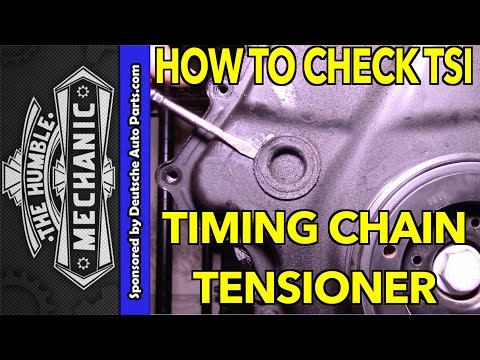

          good luck with the new engine but i would pull the rubber plug off the cover and verify you got the right tensioner before going further

            I am visiting the mechanic tomorrow in the hopes of confirming that the new engine does in fact have the revised timing chain tensioner. Can you confirm if this is what the newly revised timing chain tensioner should look like?
            HS Tuning - TSI Timing Chain Tensioner Update Kit - 06K109467K
            Is the part number for the new tensioner 06K109467K?
              I called the mechanic yesterday and asked if he could confirm that the new engine has the revised timing chain tensioner. He informed me that if you remove the inspection cover plug, it will develop a an oil leak over time. This has been confirmed in the following YouTube video in the comments section under the user "Lynx Star Automotive":
              Is this true? It's not like he is too lazy to check as the engine isn't in the car yet, how hard is it to use a small flat-blade screwdriver to pry off the rubber plug! Are there any other ways to verify? This is seriously stressing me out! I don't want to fork out another $5k down the line...
              "I love the power glove... It's soo bad!"
              • Just fit the new plug and there should be no leak.
