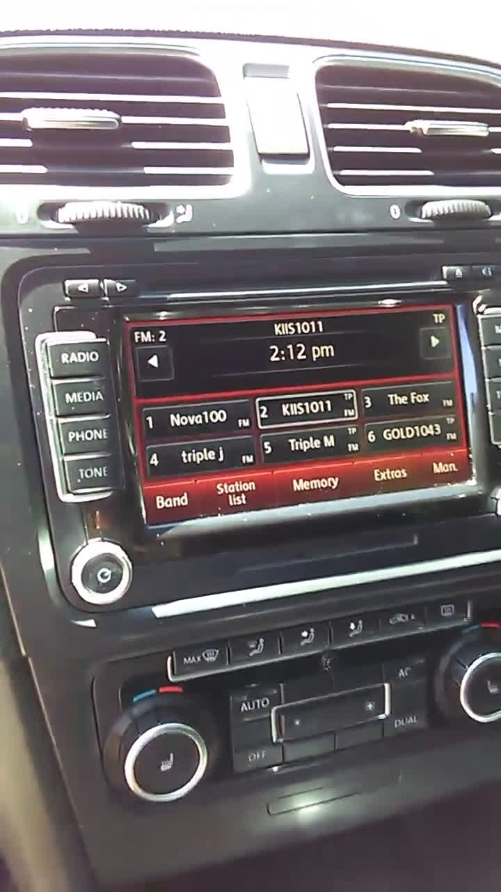

    I picked up my MY10 Mk6 Golf GTI a few days now, absolutely love it, but up until a couple of days ago, the 'Phone' function stopped working.
    It's strange. The bluetooth seems to still pair just fine, but that's about it. I can't hear calls coming through the speakers whilst on a call, music streaming no longer works, nothing.
    The other strange thing is, everytime I press the 'Phone' button on the head unit, all sound from the speakers mutes. A 'mute' icon appears on the head unit. For whatever reason, it's acting like a mute everything button. The phone menu itself no longer shows up.
    Here is a video of what I mean:
    The other thing I noticed, and I'm pretty sure I'm not going crazy, is I was certain I had a a 'Phone' option in the 'Setup' menu. That seems to have completely vanished also.

    It sounds like a connection issue between the bluetooth unit and the headunit.
    You really need to get a scan done with VCDS, should give you a better understanding of the issue.
    Maybe the coding for bluetooth module has been removed from the canbus gateway installation list?

                      A firmware load won't bring back a Bluetooth module that was there and now isn't.
                      It's either a wiring problem, or a coding problem.
                      Deal with those issues first and then you can look at a firmware upgrade if you like.

                              I had a problem earlier where the phone and nav pages would disappear from the cluster display, and the colours of the RNS-510 would revert to default. It turned out that it was the adaptation of the unit being reset when it ran out of power due to my dash-cam using the RNS-510 USB connector for power. It got fixed with a more recent firmware for the RNS-510 which seems to turn off power on the USB connector properly when the ignition was off. So I'd definitely agree with the assertion that it's a coding / adaptation issue, even though your symptoms are slightly different.
