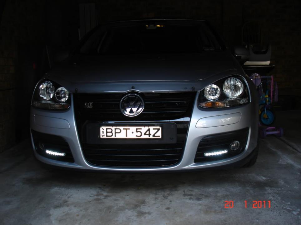

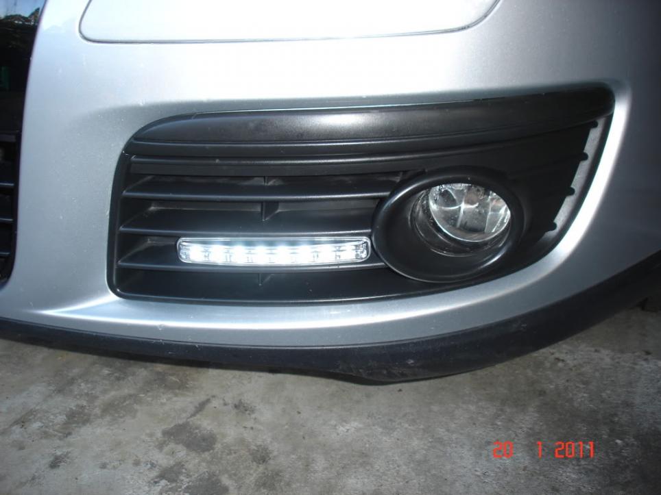

    • I installed some DRL's either side near the driving lights,they fitted exactly in between the bars ,i got a auto electrician to wire them up and he used a live ignition wire in the front R/H HEADLIGHT
      ,looks like its part of the car

            • Nice! How did you secure the DRLs to the fog grills? With double sided tape or did you screw them in?
              • First i had to remove the upright bar using a pair of side cutters then i used a sharp 10 mil chisel to pare away the rest of it once its removed i drilled a 8Mil hole in the center of where the bar was for the cables, i used roof and window silicon sealant which dries in 1 hr ,
                Ive seen others hook them up to the fuse box but the Auto electrician used a live ignition wire in the front R/H headlight very simple connection and it only works when the ignition is on .
