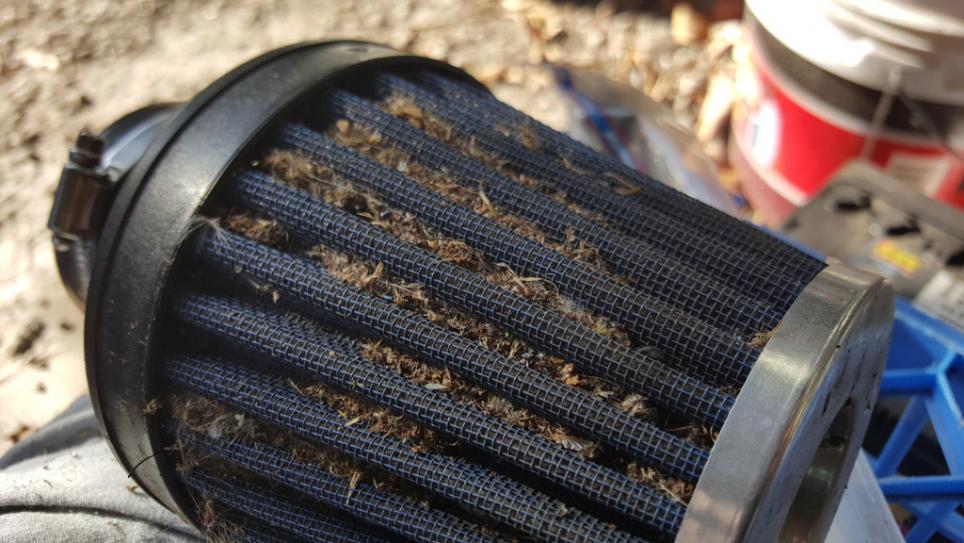

        Pulled my Forge Twintake apart today and gave it a little bit of a clean.
        There was a little bit(!!??) of stuff in there to say the least lol.
        Once brushed clean, i reassembled it all with the Forge hoses all facing upwards and the hose clamps all as hidden a possible to keep my OCD at bay.

          That air filter !

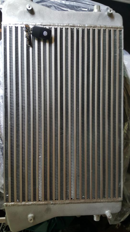

            INTERCOOLER!!!!
            My intercooler finally arrived!
            It took nearly 6 weeks but it is here now and ready to be fitted when i can find the time.

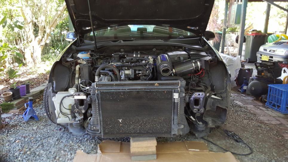

                          I finally got around to fitting my intercooler.
                          It did not go as planned as i did not notice that the turbo outlet coupler had not been shipped with the kit till i had the car appart as far as it had ever been. Rather than put it all back the way it was, i hit the faceballs and forums for some help and a really nice guy of fb posted me the coupler wich got me out of trouble 2 days before Christmas... If your reading this, you know who you are and i thank you

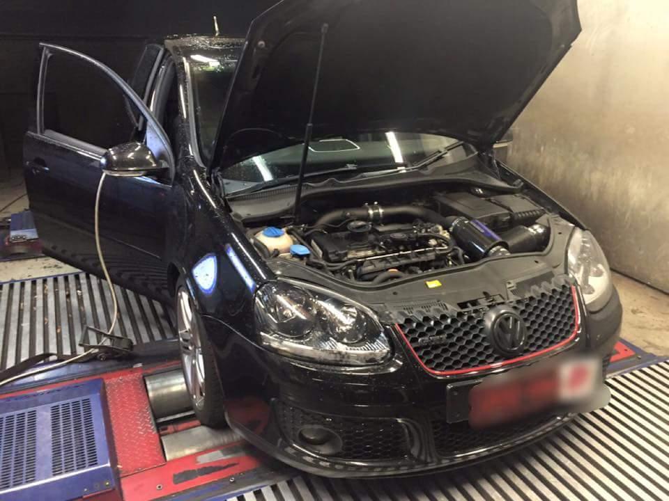

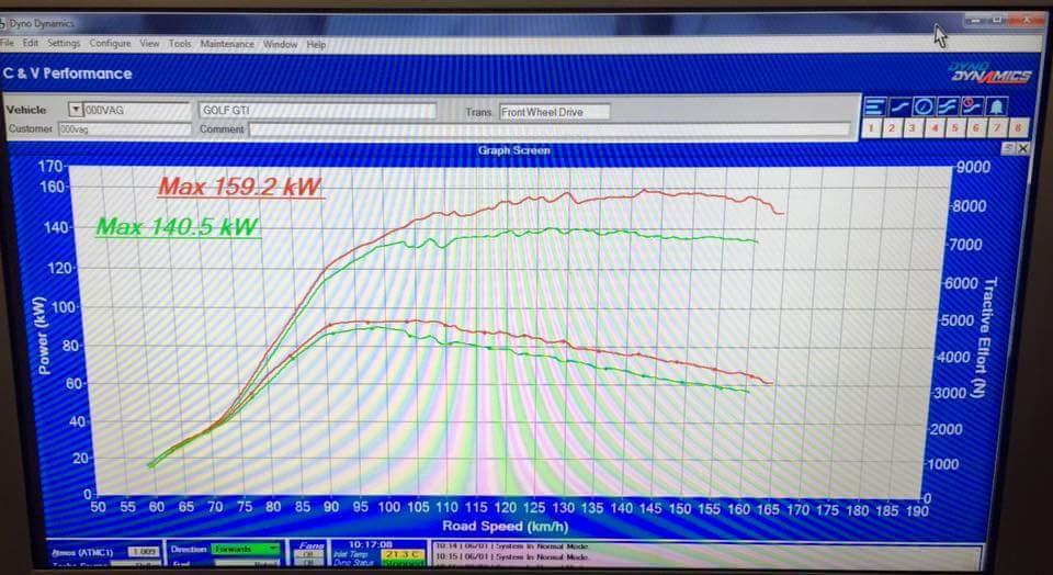

                          Payed Chris at ETuners in Sydney a visit on my way through to Canberra. Spend a good portion of my holiday money on a custom ECU and DSG tune but it was worth every cent and Chris was really good to deal with. I will certainly go back if i ever go K04.

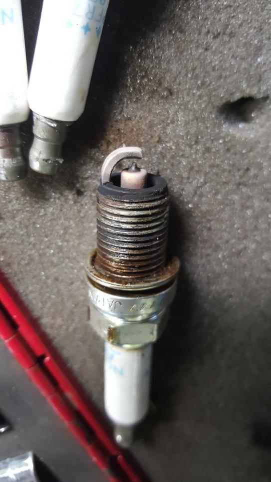

                          The ECU was pulling 3 degrees of timing due to a crappy spark plug on number 4 cylinder but i am moments away from changing the plugs today so i will call it 160kw at the front wheels.
                          a 20kw improvement over the GIAC tune with the same hardware. Not that i was unhappy with the GIAC tune but i knew i had outgrown it and was not doing my new hardware any favors without a new tune.

                            Plugs changed!
                            The offending plug.
                            So in went a set of these. I used the zip tie trick to get the igniters out which were replaced by VW under recall a couple of months ago.
