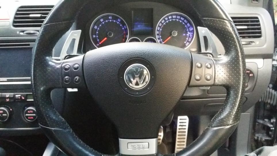

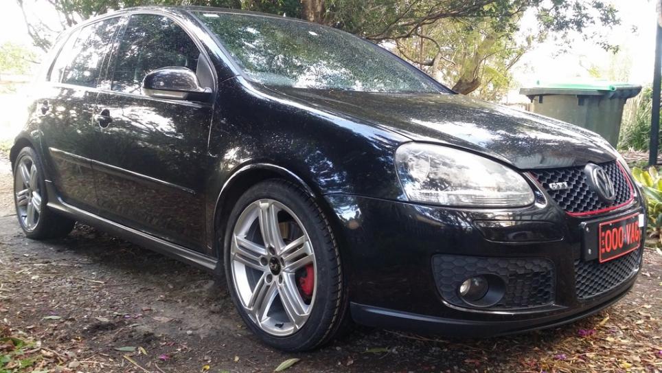

      Baby got some new shoes today!
      OEM Golf R rims.
      Not sure if ill take it upon myself to recondition the Karthoums that came off it and refit them, slap some quality rubber on them for the ocaisional track day or sell them off yet. If anyone is interested in taking them off my hands, PM me
      Also added the brushed alloy flappy paddles

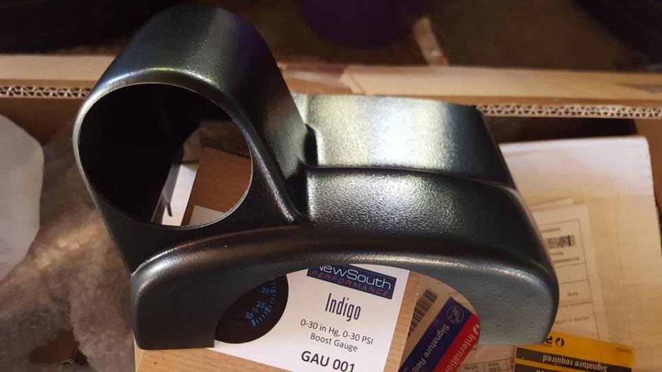

      I have the boost gauge and column mount here but am yet to fit it as i was waiting to pick up my Neuspeed carbon fiber engine cover.

        Nice! Those wheels look great mate.
        What tyres did you fit?

                Car is looking awesome, nice stance with the new wheels!

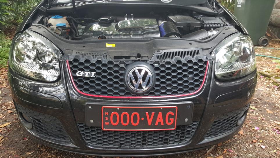

                  5 hour return road trip to Coffs and $250 later i picked up some headlights.
                  2 hours in the drive this morning and a few coffees later they were in!

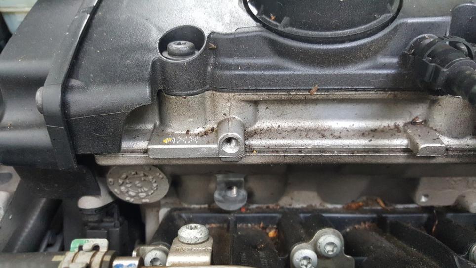

                  Test fitted the Neuspeed carbon fiber engine cover but am in need of the drivers side factory cowl bracker if i want to safely mount it.
                  It will look the goods once fitted though
                  If anyone has this part and would like to donate it to a good home, please let me know

                  Trying to decide now if i sell my Newsouth column mounted boost guage before i fit it and replace the Kenwood double DIN stereo with an 8" Android unit so i can run Torque through that or keep the boost guage.... decision decision?

                    Lights are nice and shiny again!!

                    Analog gauge like the New South would give more accurate readings AFAIK.

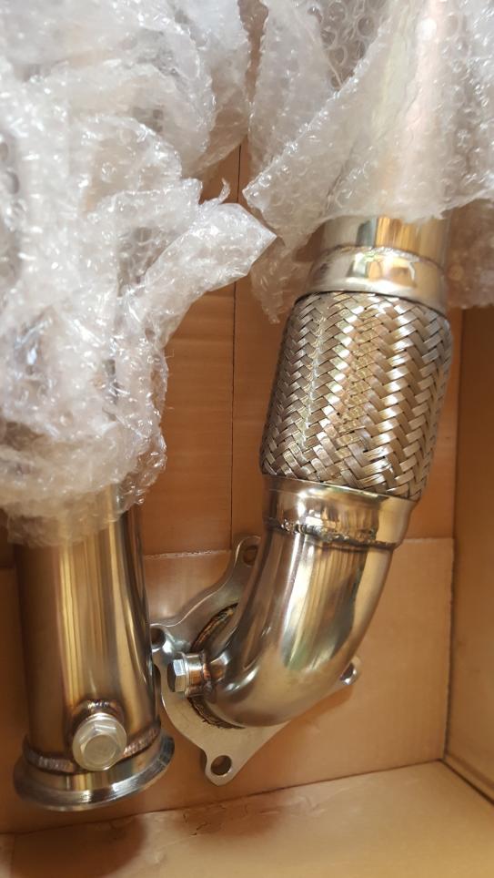

                    • #25
                      This finally arrived Friday...
                      It will be fitted along with a 3" downpipe and my boost gauge late next week with a bit of luck.
                      Photo's some time mid week of the exhaust

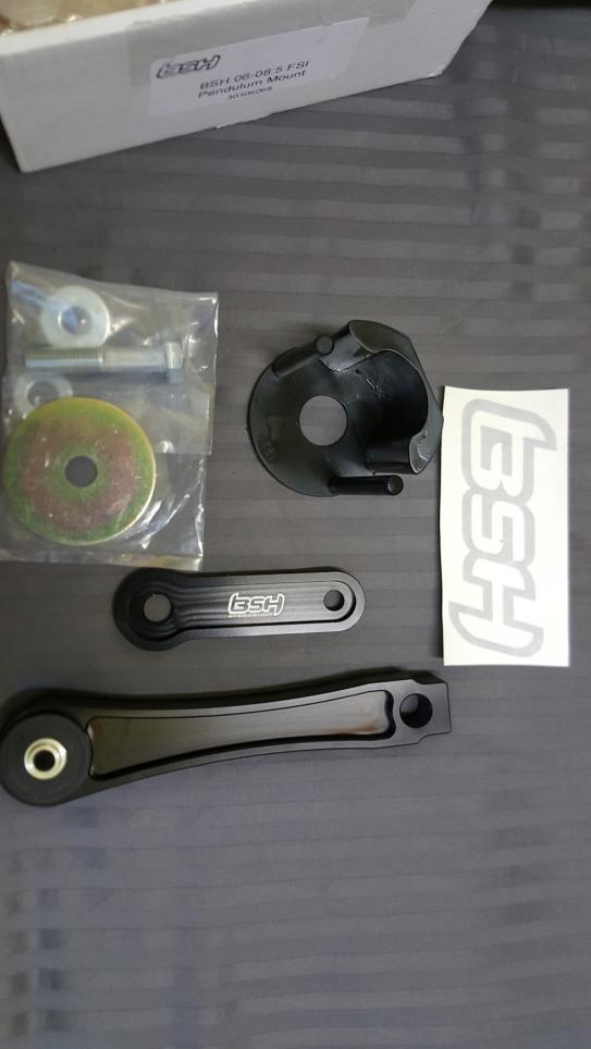

                        All parts are here and ready to go in...

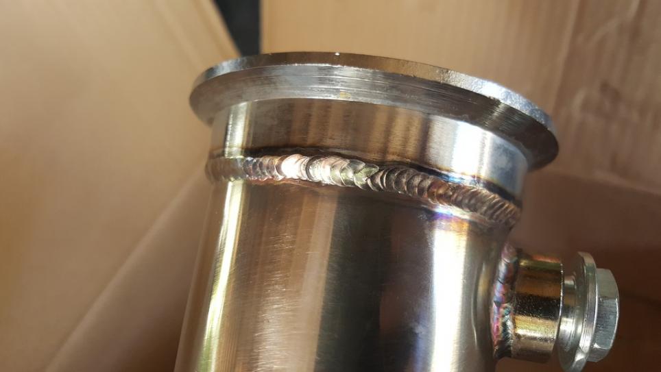

                        The welds are a lot cleaner than i had expected. Considering they were most likely done by a 12 year old Chinese kid, i say good on him. I could not have done any better and i am certainly not complaining for the price.
                        Vemon 3" 200cpi catalytic converter.
                        Colum mounted boost guage.

                        I also ordered an aftermarket intercooler to go in some time in the future. At which point i will adjust my headlights so they are not so wok eyed!

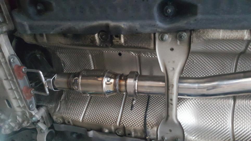

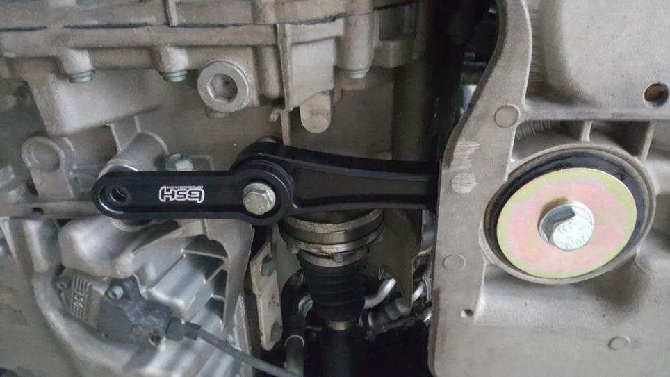

                              • #30
                                IT went well thanks Locky!
                                I had to replace one of the bolts on the dogbone as they supply a spacer and a short bolt. Did not look so safe to me as there was not many threads securing it to the subframe so i got a hold of a longer one for piece of mind.
                                I gave it a bit of the old launch control on the way home to find zero wheel hop... job done and very pleased with it so far. I can notice a very slight vibration but nothing to worry about compared to what other people have described.
                                The exhaust got welded up nicely. There was a bit of gap to fill but it looks pretty good in my opinion.
                                I had planned on deleting the Vband joints but they lined up properly and sealed perfectly even with the cheapo Chinese clamp.
                                Cold start is loud as hell as well as when it gets on boost and dumps out the wastegate but it is otherwise as loud as it was before under "normal" driving conditions. Some extra pops and burbles on over run and some really crisp DSG farts now which was a nice bonus
                                I did not use a C02 sensor spacer as i was in a hurry to get it finished but there is no CEL to speak of as yet after 200km. I'll report back if it ever appears.
                                The boost gauge also got fitted. I was a bit surprised to find it reads as high as 22-23psi in the lower rev range before rolling back to around 14-16psi in the higher rev range. That explains why it pulls so well lol.
                                I'm hoping the CPU does some re calibrating over the next few days but i have noticed it comes on boost a lot sooner and a lot stronger obviously from being able to breath now.
