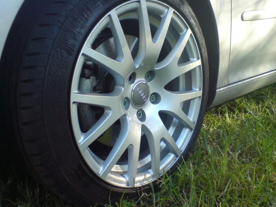

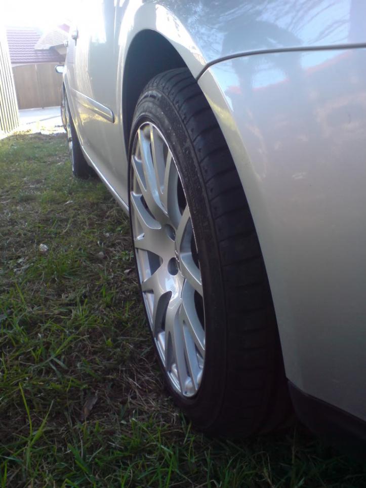

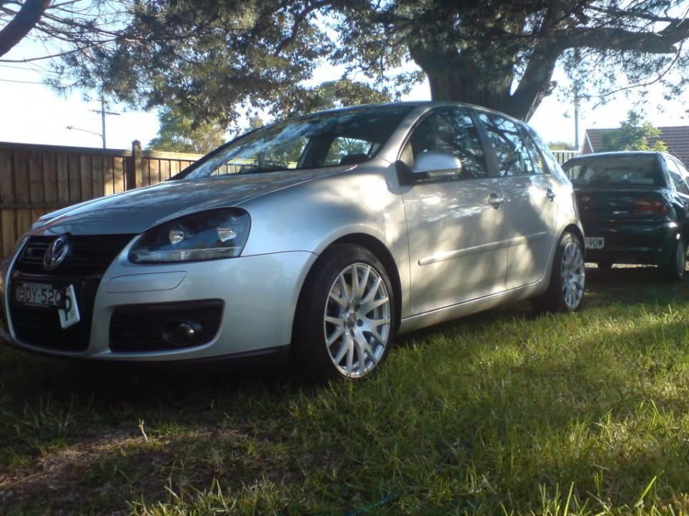

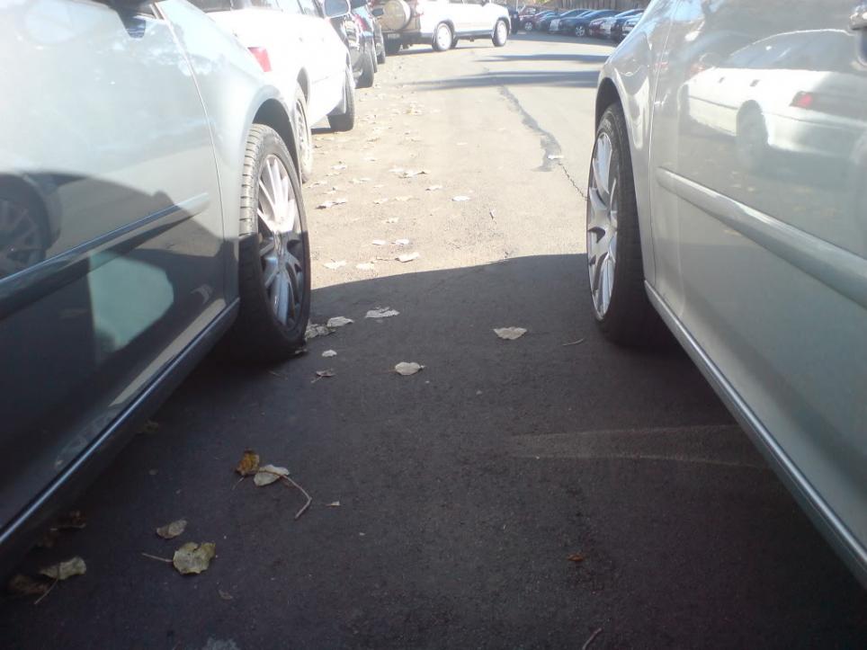

Well i finally found some wheels i like better than my stock classixs wheels. classixs wheels are 17x7 and my new ones are 17x8.5
i wanted to keep 17" as its a daily driver and dont want to spend mega bucks on tyres but i wanted something wider to make it slightly fatter and to reduce sidewall flex. they're very similar design and came from a 2008 Audi TT.
NOW for some info for you mkv'ers. these wheels i have are 8.5" wide with offset of +50 (ET50). they are only a few mil from the suspension on the front (literally a few mil) and they are right at the edge of the guards. any wider and you will have to lower your offset by however much wider you go than 8.5 inch (and do some serious rolling of the guards). hope this clarifies some confusion for you prospective wheel buyers.
so... pics ja!

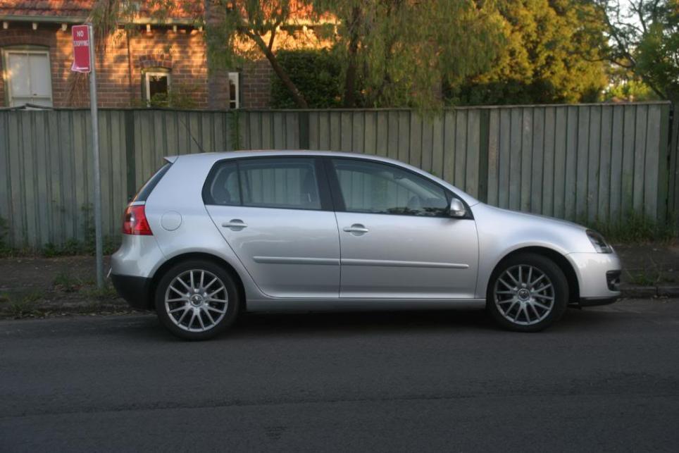

and what the stock wheels were:
