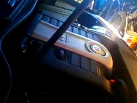

Here is the car being started cold

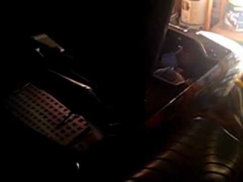

Here it is running when warm

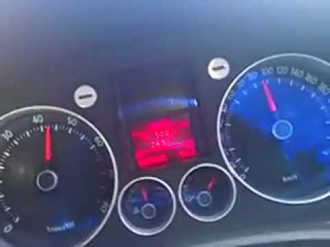

This is during driving, no rattle at all, drives perfect.
