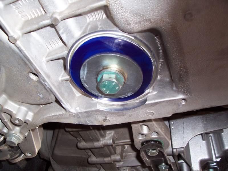

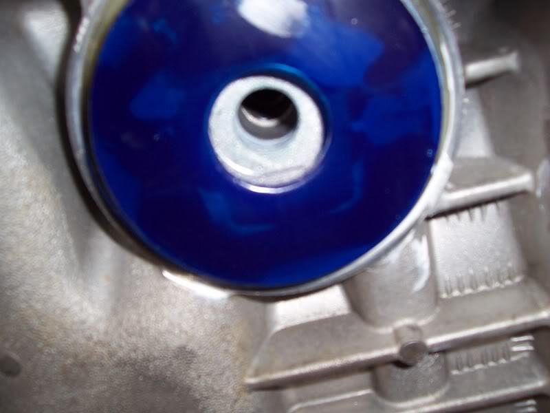

I am told you have installed this incorrectly as you appear to have two small washers then the large washer then the insert.Originally posted by gtimk5 View PostSoft blow the insert in, too easy!
Simply do up the bolt to spec, all done and a massive improvement
The samll washer should be under the large washer so basically there is a small washer either side of the large one.
I found this out when asking on another forum if the neuspeed insert is better that the APR one.
See here. read the whole thread.
I tend to agree with whats said as it does look wrong having 2 small washers where you have them.
There is the insert, the large washer and then the one original spring washer fitted. The bolt has a flange on it.
I am happy thankyou anyway.
Andrew
Did the insert come with a new washer? There should be a washer that fits in the hole of the insert, then the big washer, then whatever you originally had on your car.Originally posted by gtimk5 View PostThere is the insert, the large washer and then the one original spring washer fitted. The bolt has a flange on it.
Andrew
Correct, so as happy as he is it is still incorrectly installed. n:Originally posted by mrx View PostDid the insert come with a new washer? There should be a washer that fits in the hole of the insert, then the big washer, then whatever you originally had on your car.
The small washer that came with the kit as pictured in the OP's first picture showing the kit uninstalled should be installed into the hole in the insert, then the large washer ,then as you said, whatever was originally on the car.
I'm not picking or trying to make anyone look wrong. Im just pointing it out for others that are thinking of doing the install themselves.
It could effect the life of the insert.
Andrew has more VW mechanical experience than all but 1 or 2 people on here who have about the same amount.
I reckon that you will find that (despite assuming that it is wrong below the part that is unseen) it is installed correctly.
What you do below the large washer (below being toward the nut head) is up to you, you can put tassles on it if that is your thing.
Too many keyboard warriors out there are giving me the ****s, and this is just plain unnecessary.
Please desist on making further comments on the installation of this mount.
OK Thats fine.Originally posted by mikinoz View PostAndrew has more VW mechanical experience than all but 1 or 2 people on here who have about the same amount.
This mechanical engineer & part time keyboard warrior will keep his comments to himself from now on, I dont want to give anyone the ****s.
My apologies to anyone i have offended.
