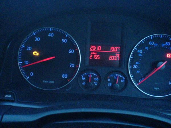

              • got the following error light (left on the RPM dial) coming up on my 2008 Mk5 Golf GT TDI (pictured borrowed from the web).
                manual seems to suggest diesel particulate filter issues?

                  If you can get the car scanned it'll tell you exactly what it is.
                  Mine recently did this and the pcv system had an issue first and then I've also replaced the charcoal canister (forgive me if these parts aren't in the Diesel engines - mines 2.0tfsi)

                      turned out to be a differential pressure sensor in the exhaust system that needed changing. $300 but was all covered under the allianz extended warranty (parts & labour)
