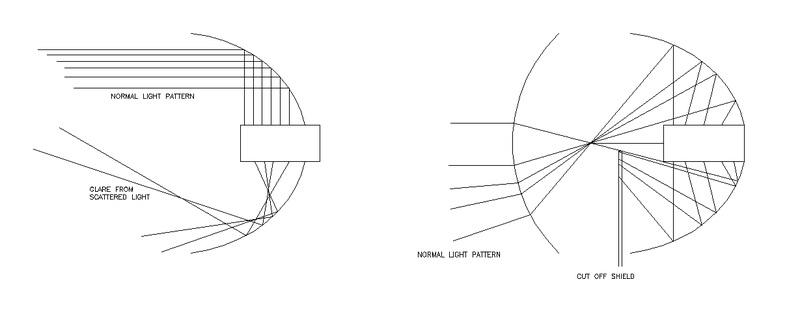

            It's really pretty simple. The reflector is designed for use with HALOGEN and not XENON and you end up with a lot of scatter. You can have a light source that measures at 10,000 lumens but it could be useless because of poor reflector design. To utilise Xenon correctly you need to use a projector hence why every car on the market with an OEM option uses projectors.
            Xenon globes can output up to three times the output of Halogen, this is a key issue with these retrofit kits as the reflector on the left is a standard reflector and are designed to send the light in one direction with some scatter and the projector housing is designed to focus all the light on the projector lense, a cut off shield prevents most of the glare and gives the sharp cutoff AND can handle a lot more light output.
            You want to do a hid conversion on the cheap? At least use projectors to stop it from interfering with other road users.
            The second point is that the OP who has researched this "german designed but knocked off in china" system has quoted the Volvo as coming standard with 8000K xenons which is incorrect and this kit as coming with 10000K xenons which will be explained below.

            Just because this hid conversion appears to put out more light doesn't mean that it does, the glare makes you think there is more light and you loose depth perception and night vision the higher the colour temperature of the globe.

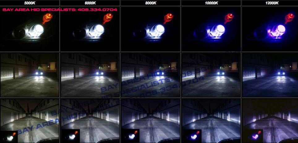

            Under 4500K you get more yellow, between 4500K and 6500K you get more white and over 6500K you get more blue.
            No OEM globe is 8000K and generally OEM is 4300K to 4800K because this gives out the most light. And there are no 10000K globes either, these are globes that are ~8000K with a coating over the globe that further reduces the light output.
            And how good are these "german designed and chines made" globes? The decent Osram/Philips globes sell for around $200+ EACH online. The cheap chinese made kits comes with a pair of globes, ballasts etc for ~$150.
            And don't think those cheap ballasts are good either. Your insurance won't pay out when your car burns to the ground or your wiring loom gets melted.
            To summerise, the higher the kelvin (temperature) the less light output you get (lumens) so stick around 4300K, if you must go for a retrofit get a projector light housing (oem where possible) and buy a good quality kit with brand name globes.
