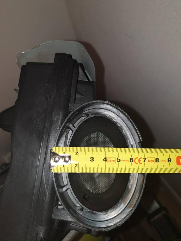

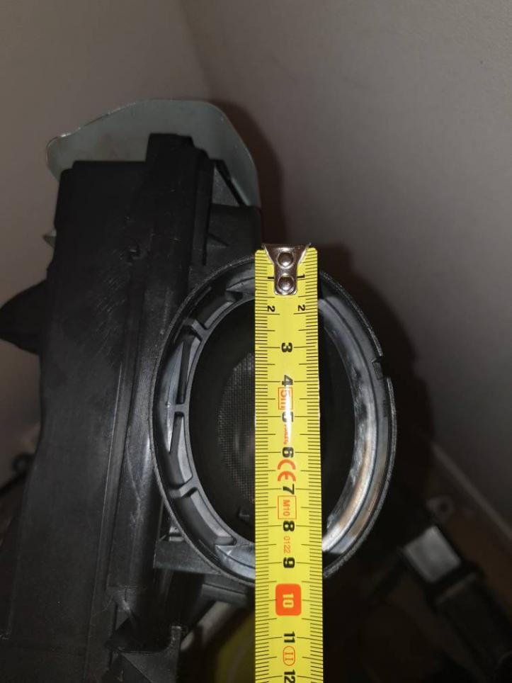

        Not sure if these help but there you go...
        Sent from my SM-G960F using Tapatalk
          yep thanks buddy. I didn't realise that part of the intake is moulded into the vanity cover. No wonder I couldn't find Mk5 Gti intakes online as a continuous bit of piping.
          Actually as I typed this I just got a message from the guy that will be tuning it to say that the 2.75in I.D MAF that I have will be the one to go with, so problem solved.
