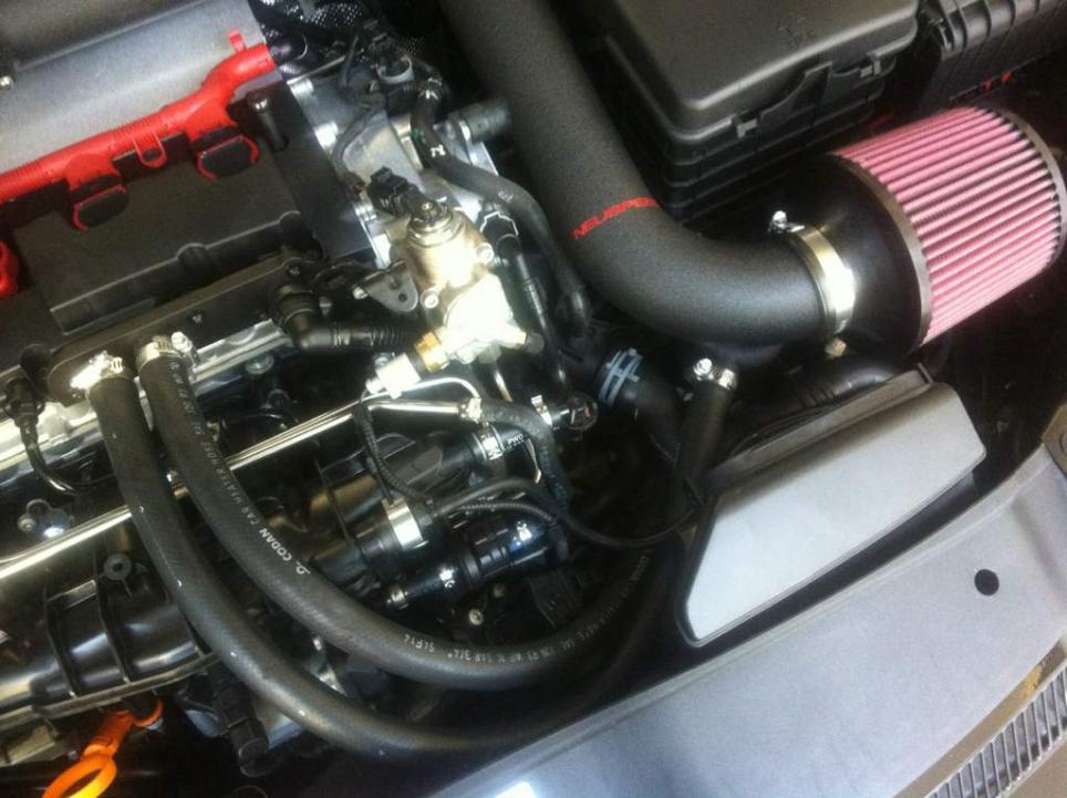

          The Neuspeed P-Flo is a nice neat and simple intake that is well designed - i also had that intake a few years ago (although i got the black version for a more subtle look).

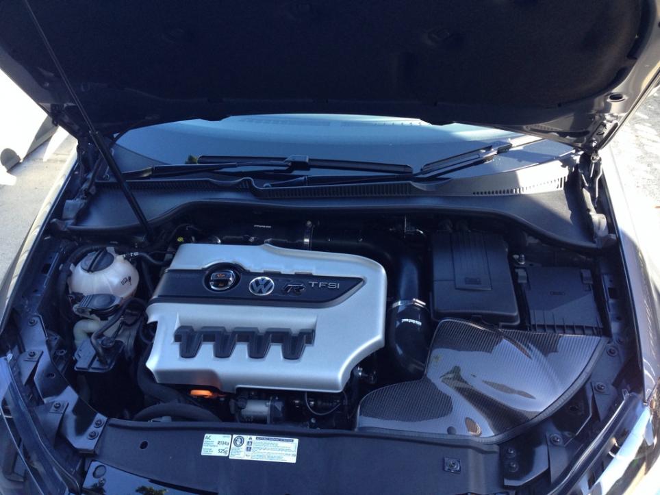

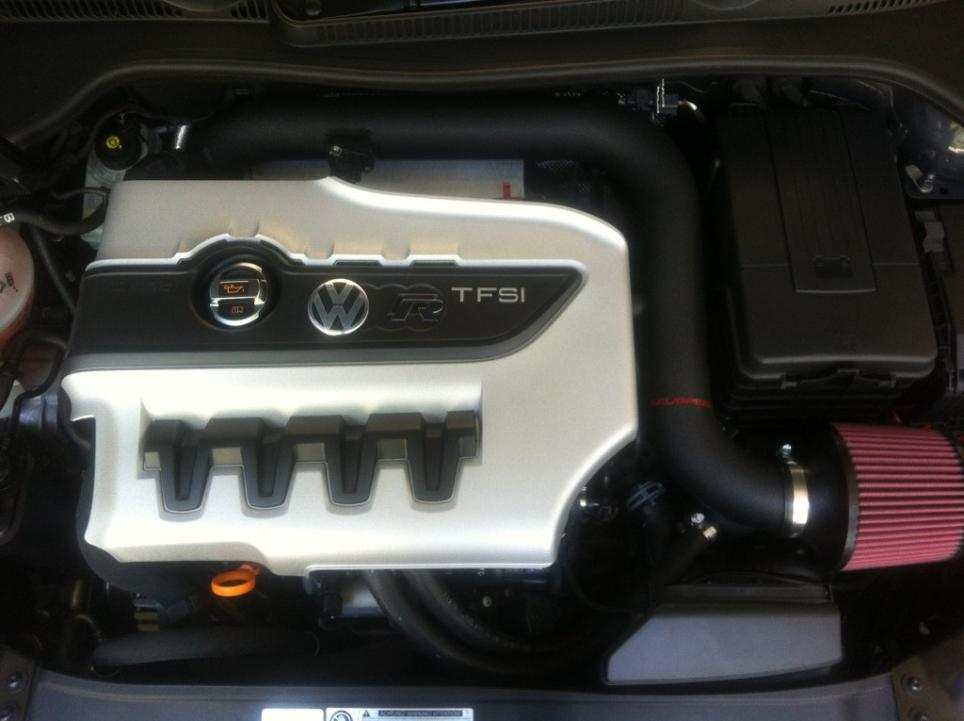

          Here are a few photos of the P-Flo when i had it fitted to my Mk6 Golf R:

            Nice - love the engine cover! I think I remember these photos from when I asked for advice on catch can setups on this forum... I'm guessing you never tried to make an enclosure for the filter?
              That's an engine cover from an Audi TT-S which fits on the Mk5 GTI and Mk6 R engine. You can see my catch can rubber pipes coming out from under the engine cover and i had mounted my catch can underneath the air filter.

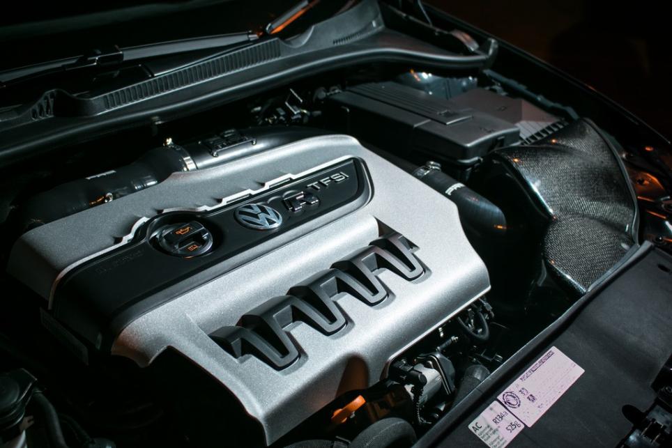

              I did end up with a carbon fibre enclosure for the air filter which i customised to make fit which i was very happy with in the end, but i used a different intake because the NeuSpeed wasnt on the correct angle to fit the enclosure and was a bit short in length. If it wasnt for those reasons i would have been happy to keep the P-Flo intake.
              The intake i settled on was an AmD Tuning intake which had more silicone in the design which allowed me to adjust it perfectly to suit the carbon fibre airbox. I also ditched the huge oiled foam filter that came with the AmD intake for a smaller profile but longer AFE pod filter.
