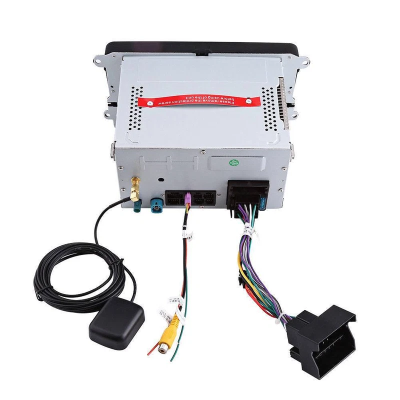

I've recently upgraded the stereo in my 2007 Golf (with the half cluster dash) from the RCD310 unit to an aftermarket unit I purchased from an online store.
Everything from removal of the old unit to the new WinCE based unit has gone well, even the installation of the ISO cable loom and harness, GPS antenna and aerial connection. However there are 2 issues I am having with the unit and need some assistance and guidance with please.

Link to images of head unit and cable harness installed below:
