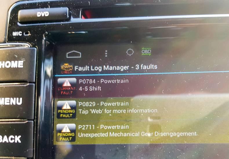

    Codes below appeared:
    P0784 (power train)4-5 shift
    P0829 (power train)
    P2711 (power train) unexpected mechanical gear disengagement.

    These are the generic SAE codes.
    You need to use something like VCDS to get the manufacturer specific info out of the faults to make a proper diagnosis.
      Thanks mate. I retrieved these while at the side of the road...
      I'll pull out the laptop with vcds and see what it says... Probably shouldn't of cleared the codes though!
