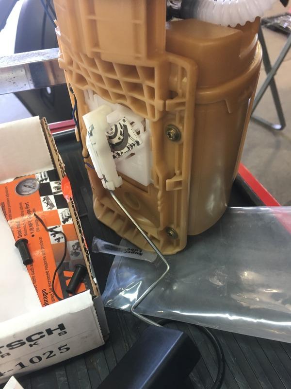

          DW pump (thanks for the tip Lito!) and new level sender fitted

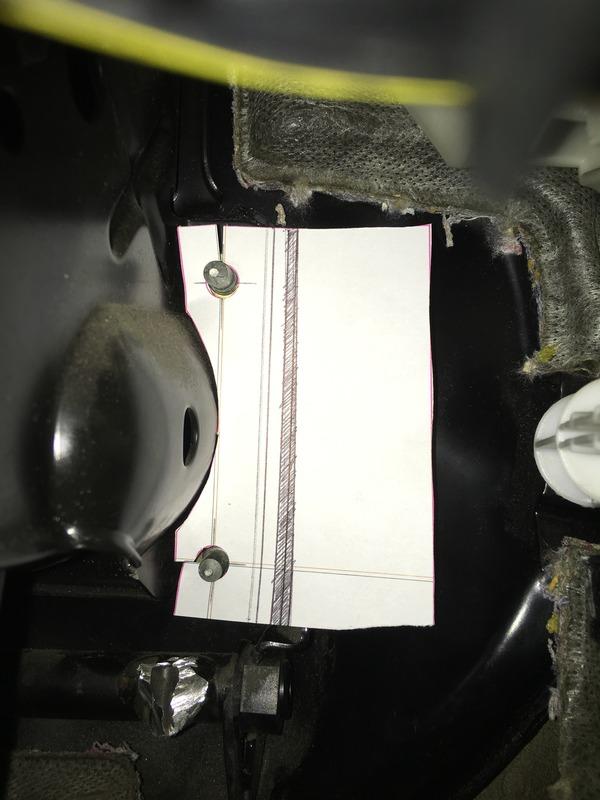

                    Originally posted by simmo675 View Post
                    you take your seat out when you mounted the peddle box..your ballsey going straight into it,give you that..im planning on-if I do- rigging it up out of the car to see if i can fire it up firstly..regardless top effort bruv
                    DEEP POCKETS NEEDED
                    • #40
                      Nice work, good to see some more people doing the me7 conversion!
                      • #41

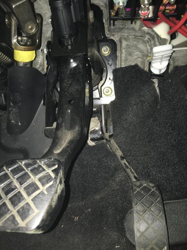

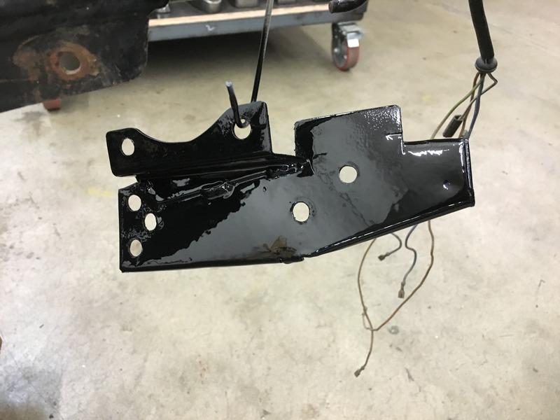

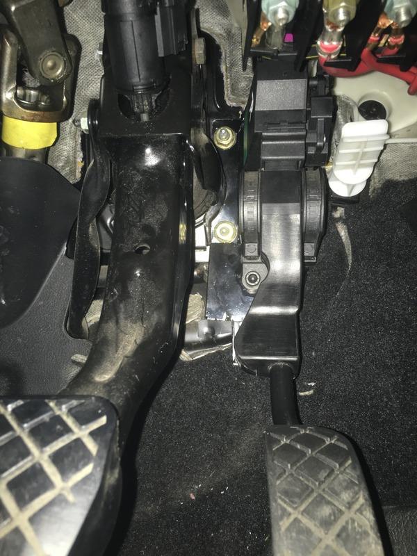

                        No mate, slid the seat back as far as it would go. Made a cardboard template for the bracket and used the two bolts next to the brake pedal mount - no welding. I have some pics somewhere of the bracket before it was fitted. rolled the edges for stiffness, will see how it goes.......

                              Ha, there was one teensy bit of welding; on the pedal bracket to add the bolt mount section. But didn't weld the bracket to the car, which would have been a bit dodgy with all the plastics/carpet etc and no room.
