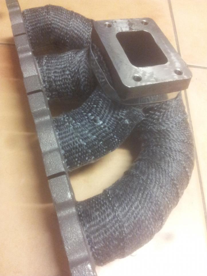

    I also have top mount, but a cheap Maximizer manifold that I cut the T3 flange off. You can buy adapter plates, but I see that as another leak point

        t25 to t3 (as i know that mani is only available in T3.... so annoying)
        also - without the heat shield on top of the turbo - how much clearance is there above it?? looking at a mani without the EWG but maybe add this?
        T3 to T3 Turbo Flange Adapter, Flanges, XS Power Inc.
        If youre after a top mount t25 manifold im using this one made by a german company called bartek
        Works with a rhd downpipe and you can keep stock ac lines... Just barely

              It's a T3 housing, no adapter plate, so that helps with the overhead clearance.
              I'm guessing on the clearance a bit as I don't have access to the car today - around 10-15mm from memory, maybe a little more.

                        Hey mate, its the DEI turbo shield:
                        DEI-TURBO SHIELD
                        A bit spendy but I'm over buying chinizzle crap and having it fall apart in minutes....I think I paid 350 +GST - Motorsport Connections get a lot of my hard earned (they're just around the corner, lol!) so a bit of a deal was done. SpeedFlow lines and fittings they do are top notch and the Jiffy-tite quick connects are a lovely piece of design and engineering....
