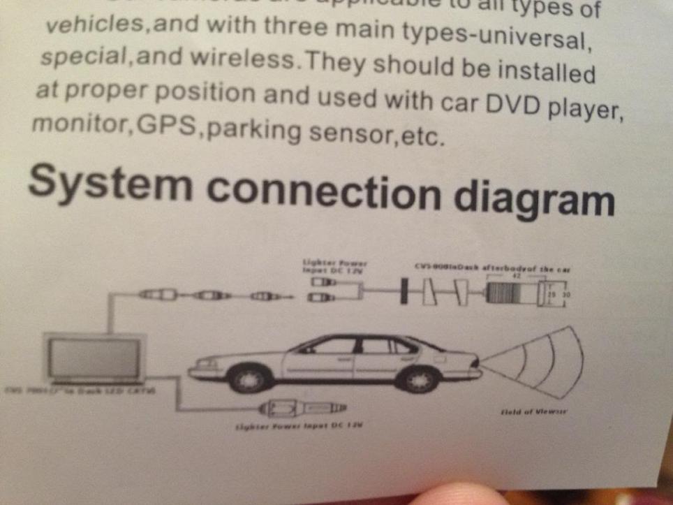

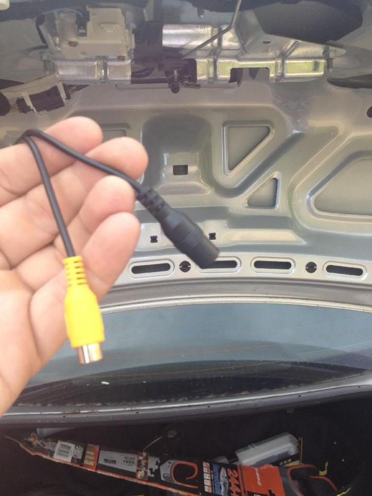

            Wiring in my rearview camera, cant work out one thing.. the yellow AV cable has a red cable attached,
            The camera has a power jack (which i connect to the rev light) i just dont understand whats it for,
            The instructions are in chinglish and the diagram sux ass anyh ideas>

              Just a stab in the dark is the red connecting to the reverse sensor on the shifter?

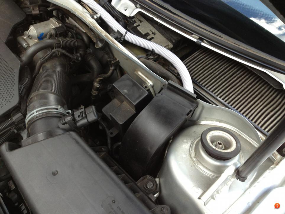

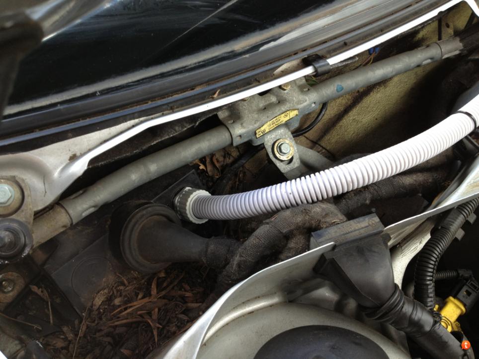

                  Hairy_mic's V5 Bora
                  Finally managed to get the time to route my amp power cable went for the black plastic cover above the fuse box

                    Hoped you cleaned the half a tree from your rain channel
                    2.0 TFSI Stage 2 Tune by DriverMotorsport
                    • #25
                      Yes. Lol, hoovered it out, noticed that the pollen filter was filthy, so gonna order one.

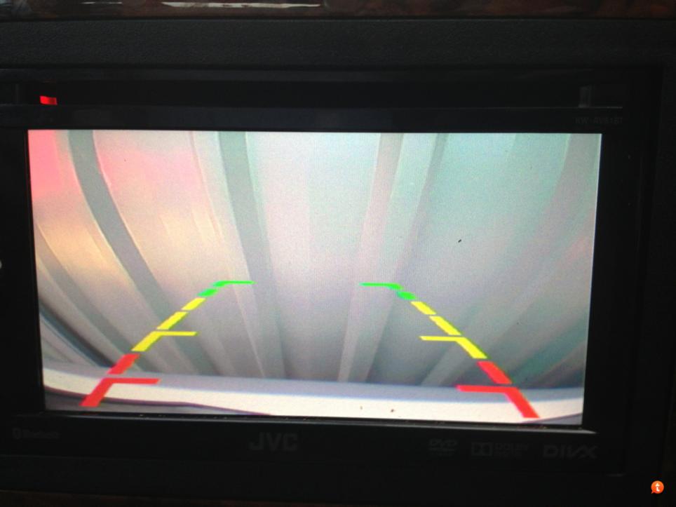

                        Hairy_mic's V5 Bora

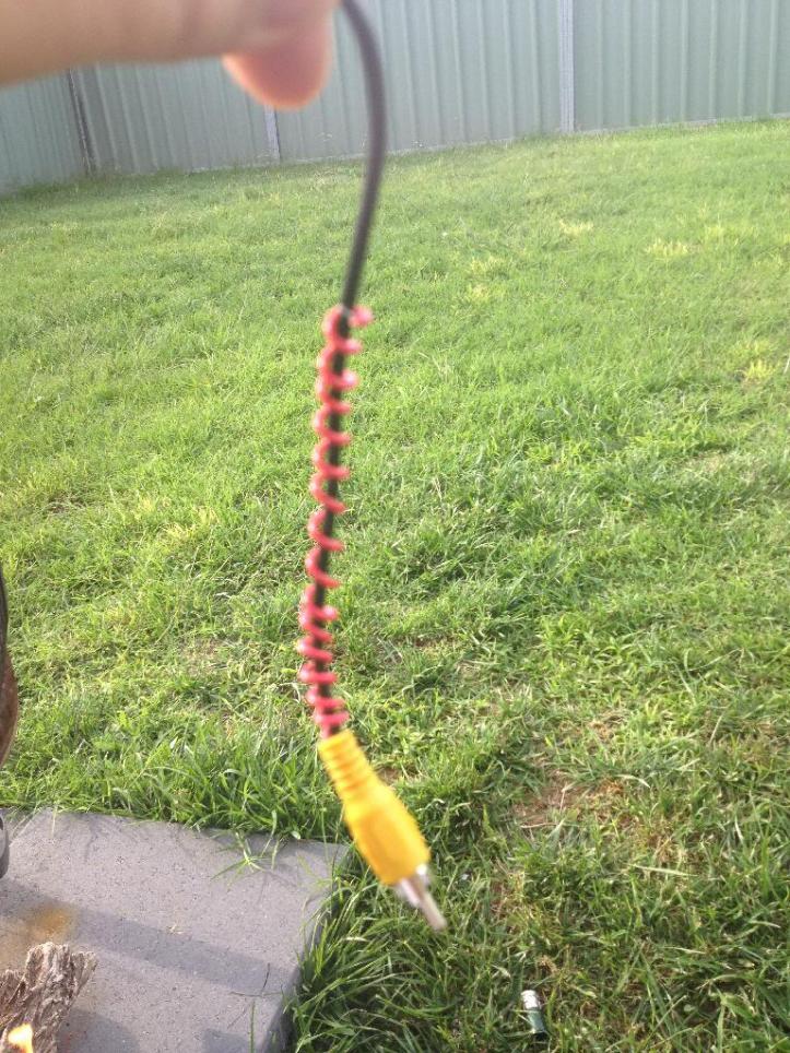

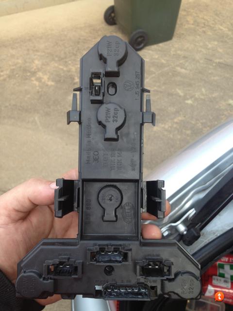

                        Sort of... but you were close enough for me to Work out. the little red wire is connected to the reverse cable on the head unit ( I didn't realise it had one) and it is powers through the rev light ) I managed to get it all in and working, also managed to avoid cutting any of the original car wiring by taking advantage of all the spare terminals behind the rear clusters

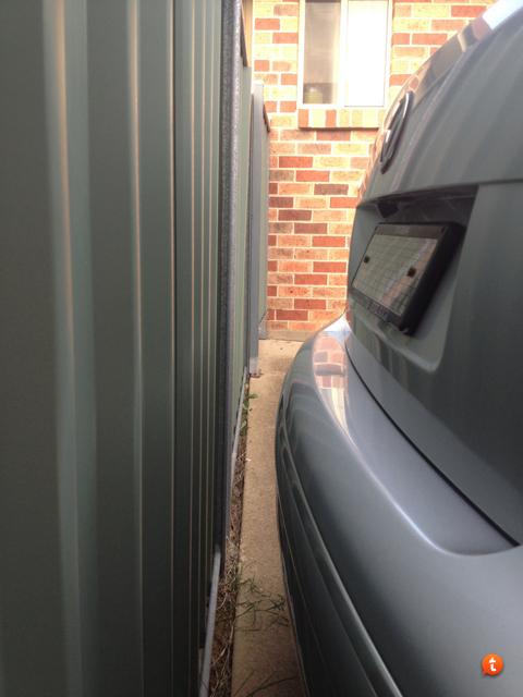

                        The camera is pretty decent, but as camera is fitted to number plate light it can't fully see over bumper but the results are pretty decent.

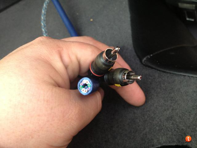

                        9 core wire from stinger ( makes rear to front audio rewires a doddle)

                          Lol realised I only brought 2 RCAs through lol

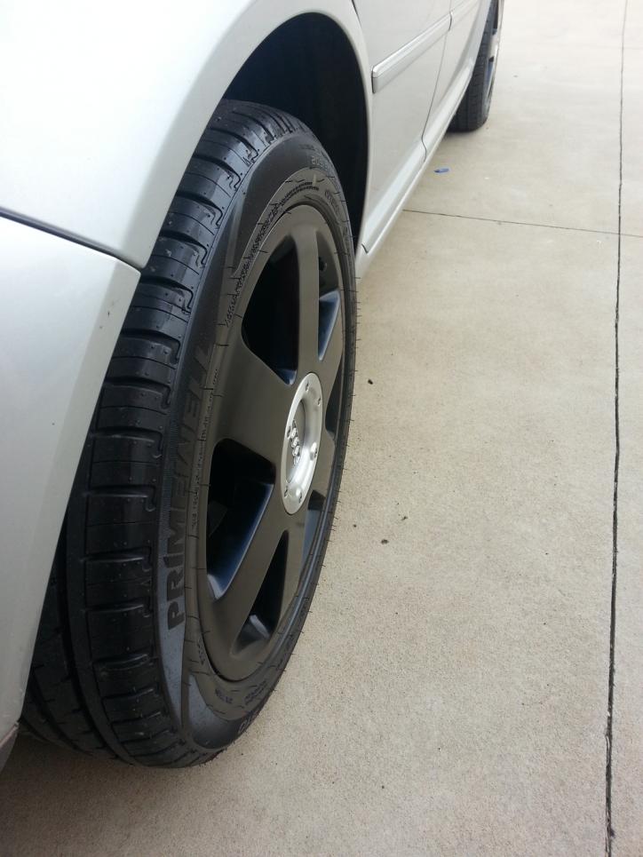

                            New rubber finally,
                            Audi 7.5j Ronals 205/50r17
                            coilovers here, installation kit on its way
                            pics are taken parked on 5deg slope. cant wait to get it lower!
