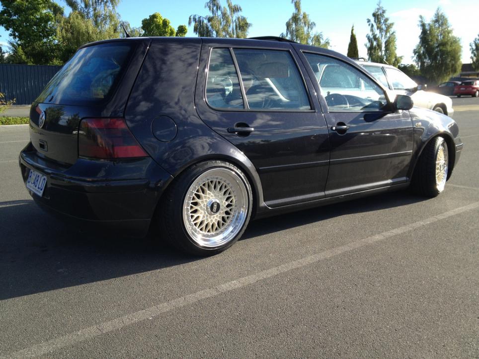

      Finally have the wheels mounted, Horrible iPhone photo. Needs heaaaaps more low, but didn't have time to wind down the coils. Hopefully get to that on the weekend and take some proper pictures, and wash the car.... haha

        JIZZZ. looks awesome. final widths and offsets and tyres??

          thanks man! Final offsets from memory et18 front and et24. 8.5" fronts 9.5 Rears. In hind site i could use maybe a 5mm spacer in the rear. Have you stacked spacers on adapters before dylan? Tyres have been stuffed up a bit, I was at the tyre place talking about what tyres i wanted whether going for 45 or 40 series.(45 on the rear and 40's on the front for ultimate lows!) And i went for 45's all round, but the fella must of got confused and ordered 40's for the front and they had to be ordered in. Couldn't be bothered after all this time to take them back and wait for more tyres. So I'm just gonna run them, and try to go as low as possible in the front. So they ended up being 215/45/17 rears and 205/40/17 fronts. definitely will need to find someone to do a frame notch if going to pull these fronts off!!!

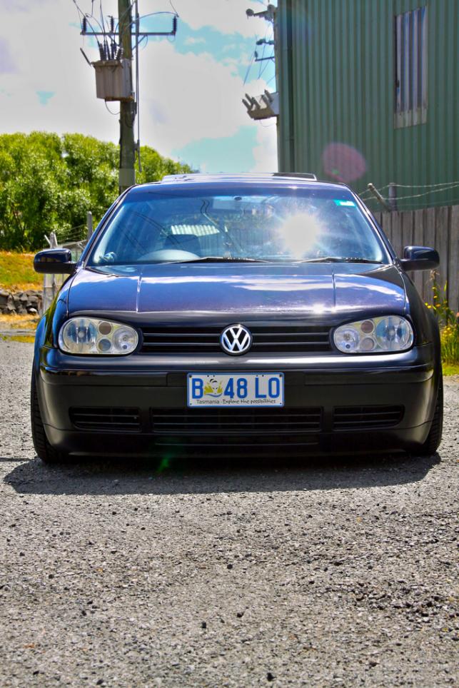

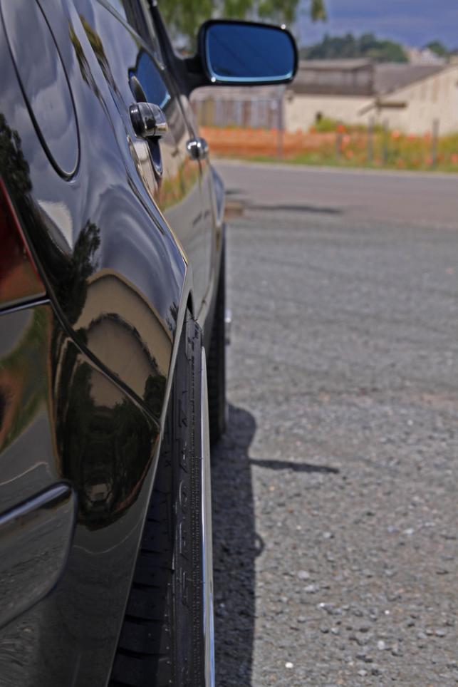

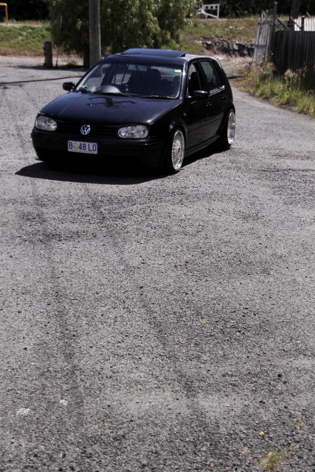

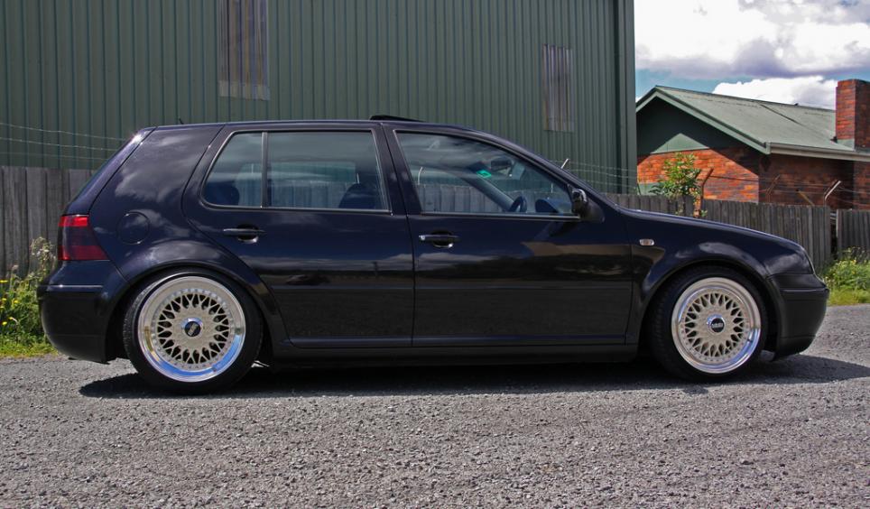

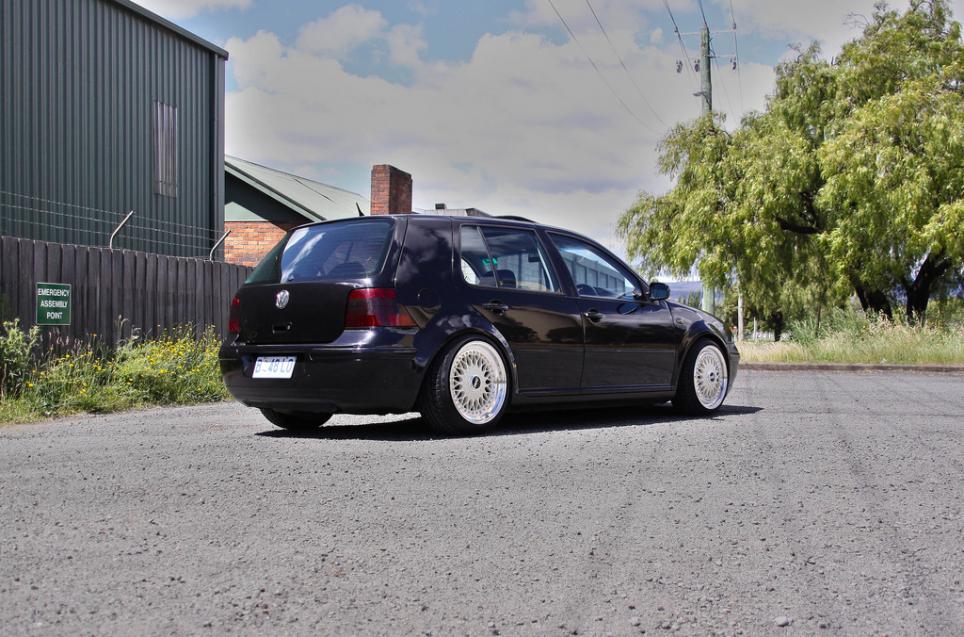

                real quick photoshoot, bad need of a polish! This is with perches out in the rear, almost all the way down on the coils in the front. Still needs more low in the front, but may have to wait for notch and maybe some motor mount spacers.
                • #23
                  looks awesome mate.
                  the HTs arent that low in the rear if thats already missing the perches huh? I think the ride height looks good though. Keep it driveable
                  whats next on the list?

                      thats a 215/45 with a fair old stretch... its pretty low.
                      looking good mate, wouldnt mind some more lows up front to be bang on tho...
                      I did run a 5mm spacer behind my adapters up front when I was on my BBS, but id just be keeping a eye on bolt length and how much of the adapter is left sitting on the hub
