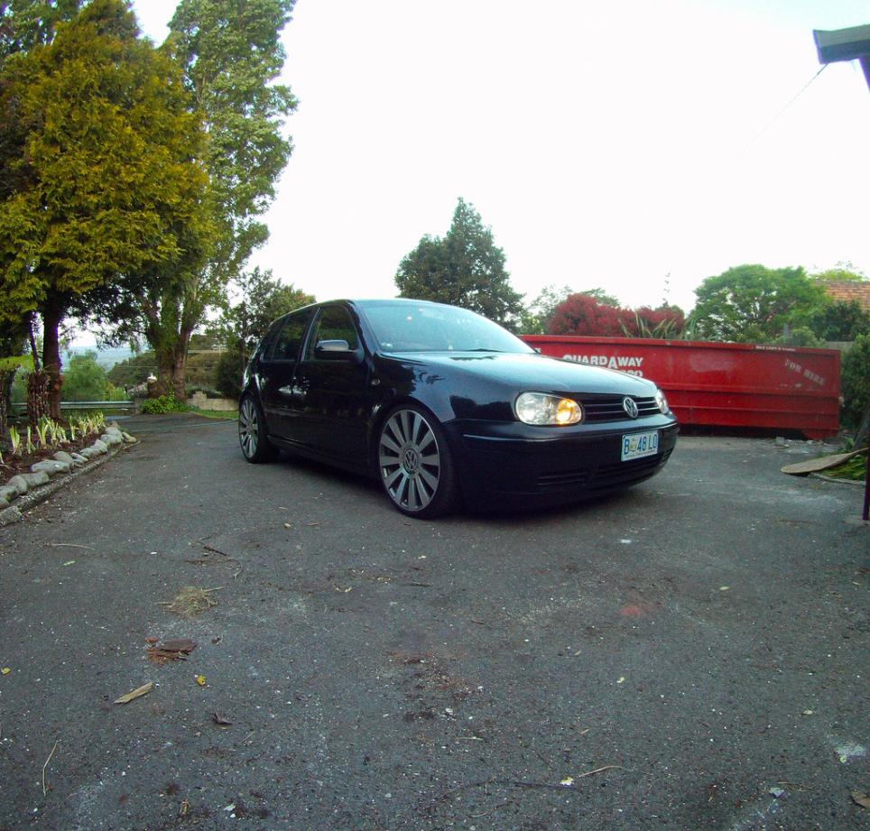

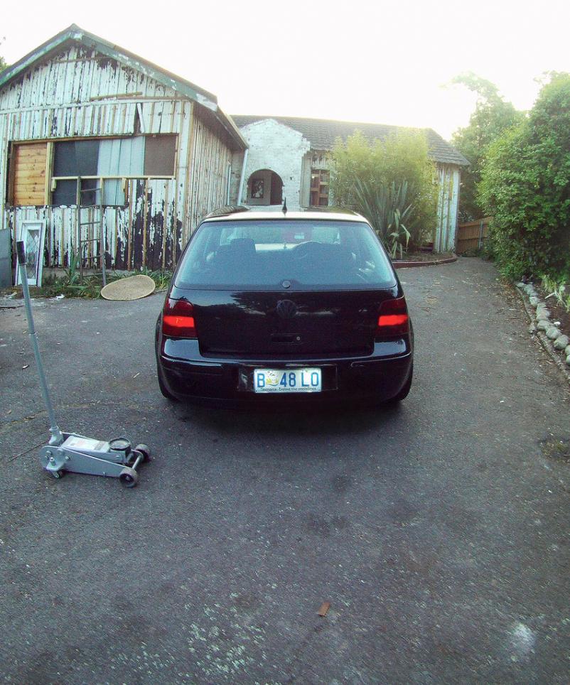

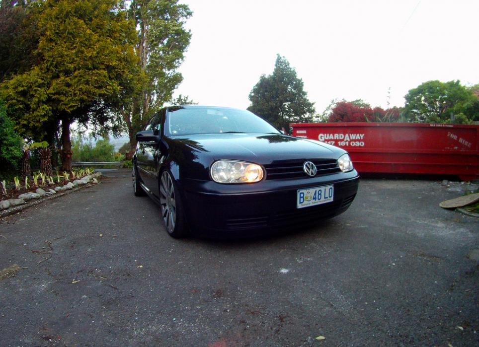

    I don't think i've ever actually posted any pictures of my ride. So i thought i might as well chuck some up. This is where I am at with it at the moment. Wheels and and stance will be changing within the next few weeks.
    Just a few dodgy pics shot with my go pro
    Mods to date isn't really much!
    Engine wise
    -Forge CAI
    -Forge DV
    -Hottuning Coilovers
    -19" audi A8 reps
    -Hella Euro Tail lights(Looking to maybe go back to stock if anyone has any up for swaps or something!)
    -rear wiper delete
    Thats about it, basically all the money i have spent on it is just on maintenance!!

    Finally!
    Think thats the best iv ever seen a mk4 sit on A8s. no reverse rake, nice and low up front

      Nice clean looking car - looks good.
      How do you like the hot tuning coils?

        So Nice. Go Pro is hardly dodgy
          nice golf looks good.
          do you have any rubbing issues with the 19s.i got a mate that just bought a set with no tyres heaps cheap and is worried about rubbing.
            Rim diameter has nothing to do with rubbing - as you run lower profile tyres to ensure you keep the same diameter.
            Offset and width contribute to rubbing - get that right, and you're OK.

              Coils are fine for the price. A tiny bit harsh but you get that for 400 buck coils!
              Yeah let me know about the tails, Still not 100% on going back to stock but could be a go!

              No rubbing on the rears, Front rubs a bit when turning while entering a driveway or such. But i have yet to roll my fenders and I'm pretty sure there would be no rubbing after that.

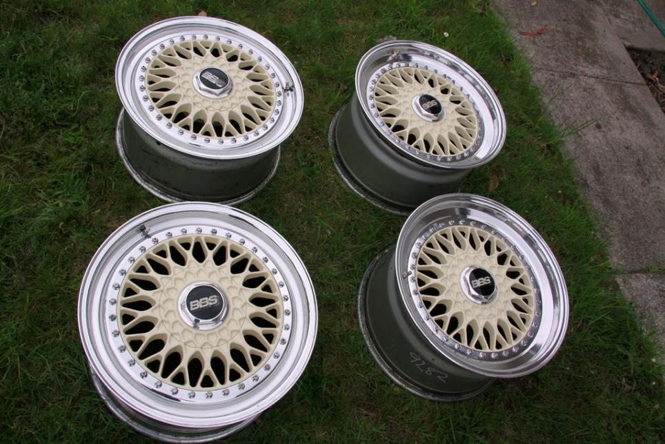

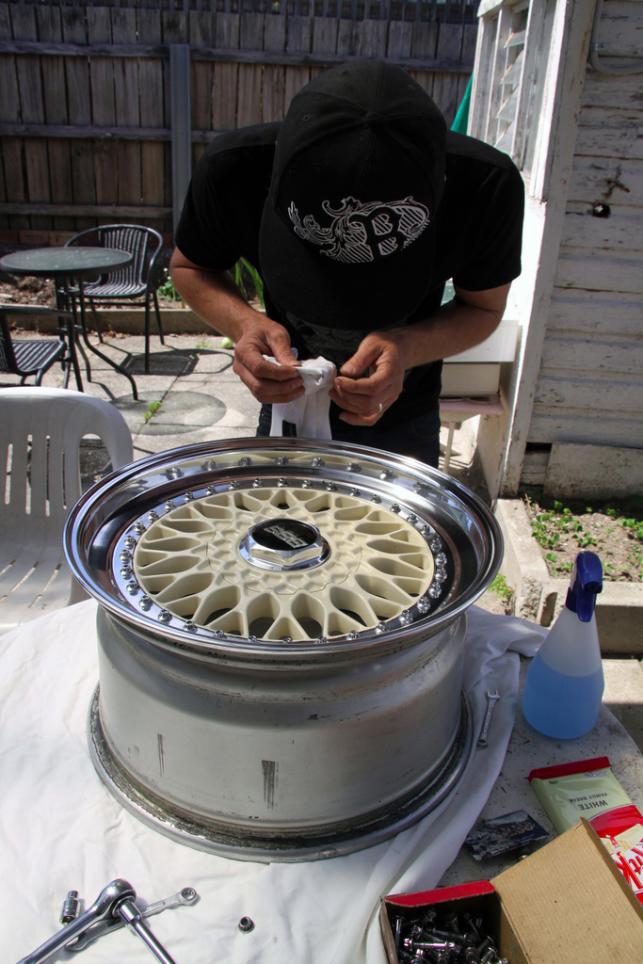

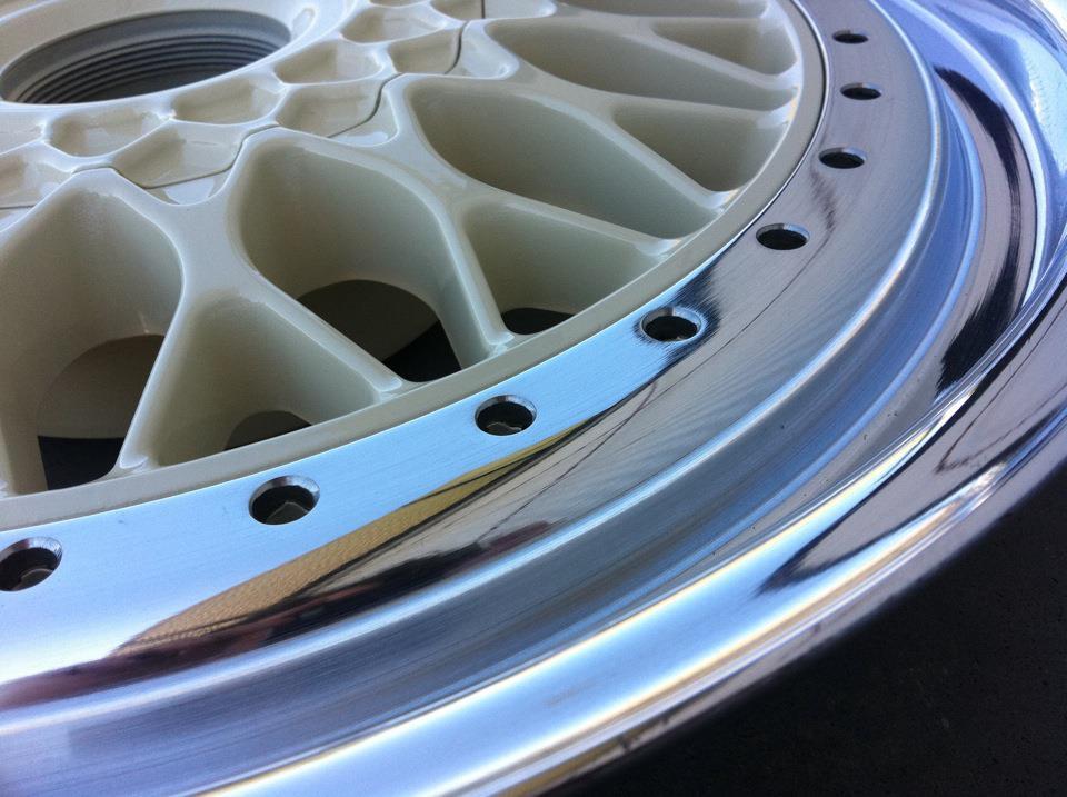

                  Wheels nearly completed!
                  Polished stock lips for now, bigger lips to come
                  Hand Polished bolts
                  Hand polished center caps(I'll get pics of them later I have already posted them somewhere on here!)
                  Rubber should be on within the week.
                    very nice....car is gonna look tighttt

                      awesome rims. looks schmick as. agree about this ride. already looks nice, rims will set it off.

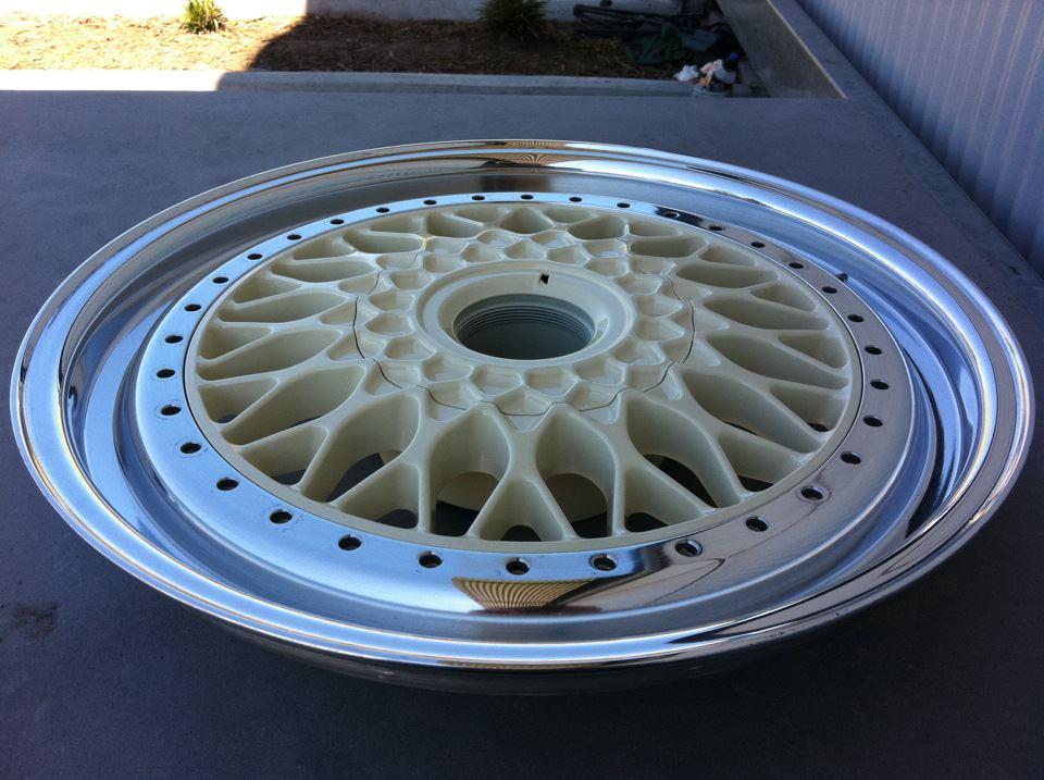

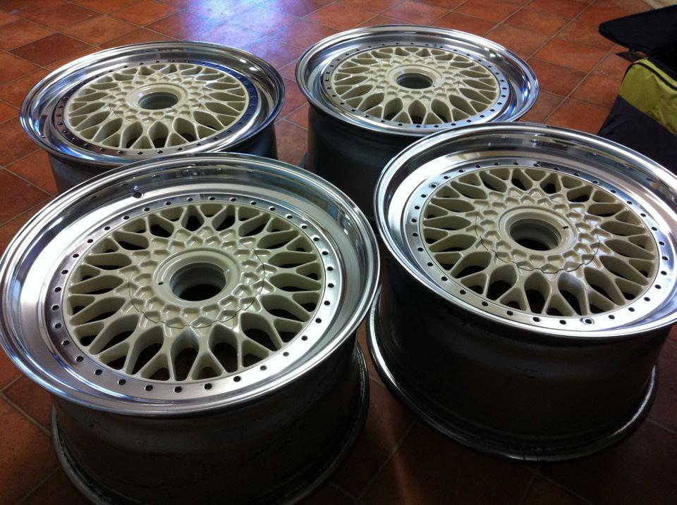

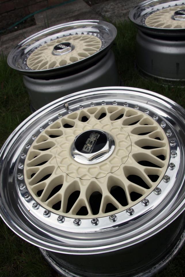

                        Put the wheels together today, Pretty happy with how they came out. Although found one crack that i never saw and never got fixed. Pretty annoyed, was hoping to get the rubber on wednesday and then put them on the car. Now i have to wait to get it fixed!
                        More pics
                        Specs are:
                        Fronts 17x8.5 et33
                        Rears 17x9.5 et43
                        Adapters are 15mm front and 25mm rear(i think from memory, this has been a long ordeal haha)
                        Also i need new centre caps, Three are ok but one is pretty smashed.
                          They look great, you did a good job on those.
                            love the colour choice!
                            going to be some fat specs for sure

                              thanks dylan, I'm pretty happy with it! Haha yeah still haven't even had them on the car yet to check the specs. Fingers crossed, its gonna be freakin wide tho.
