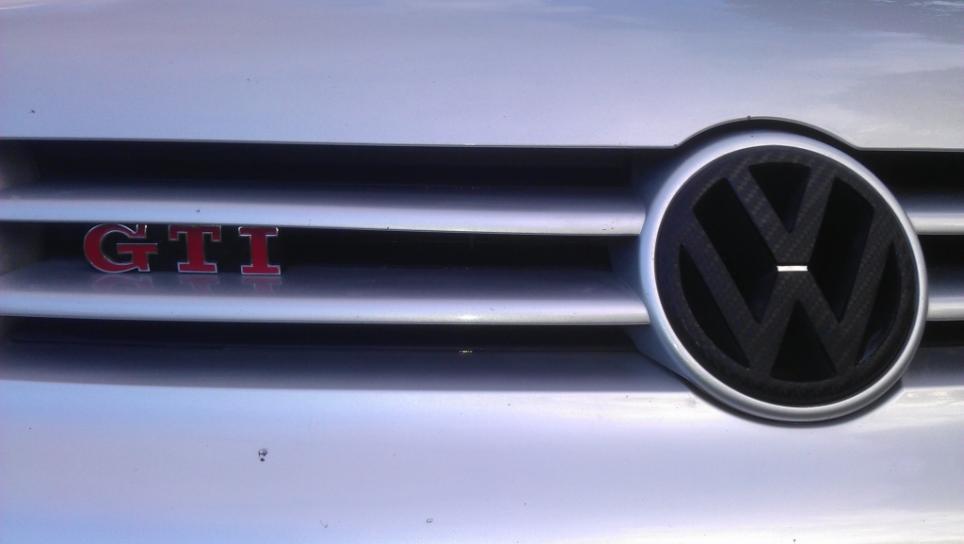

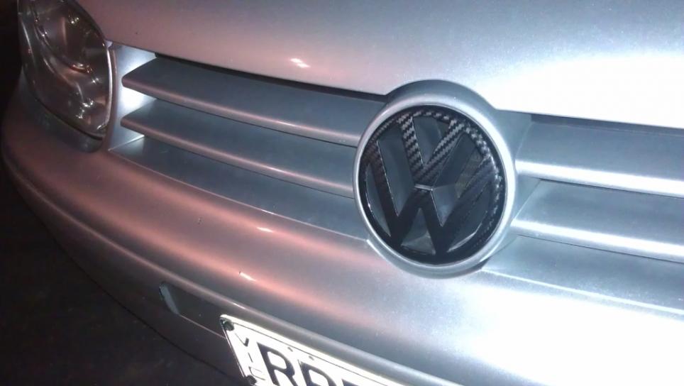

        got some 3M CF vinyl (wich is actually textured) to redo the interior, and decided to have a play first (as i cant open my pass door, so interior will have to wait to do it right). Test came out nice, i really like it. theres a bit where i cut a little too close and a tiny smidge of chrome can be seen, so ill redo it in a bit once the interior is done. breaks up the front of the car. hopefully it weathers well. it should be good for around 5 years.

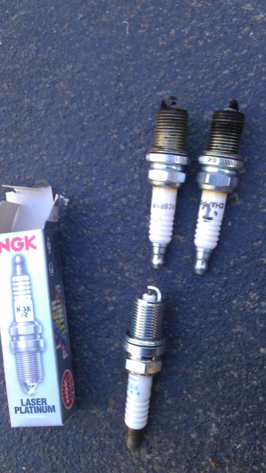

              Took out the crusty champion plugs and put $100 worth of ngk platinums in. Also drained, flushed and refilled some fresh coolant. All in preparation for the tune I'm about to get.
              Will re upload all my photos that got deleted in this thread too.

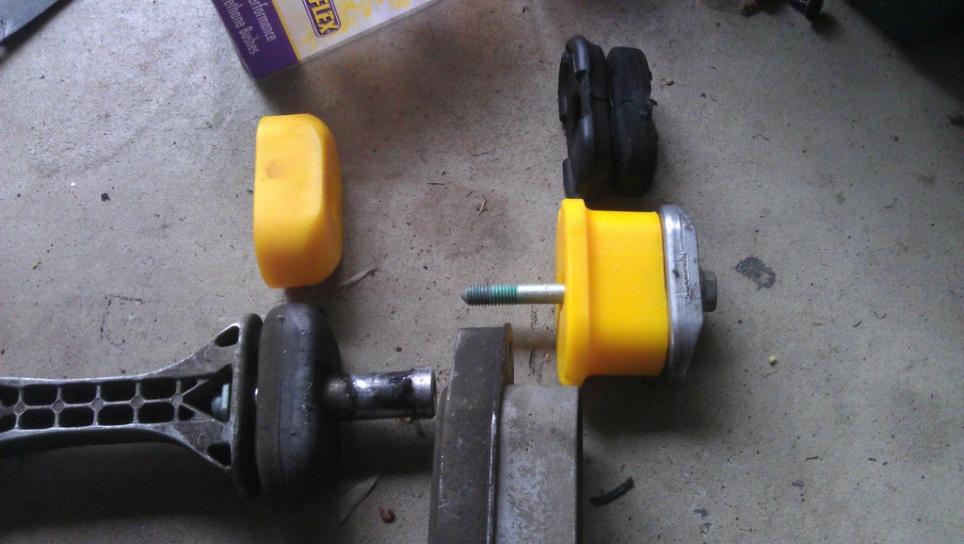

                • #68
                  dogbone bushes was all easy until i had to compress the new bushes to get the bolt going. took a while. ended up using two spring compressors which worked a treat once i finally realized the bloody nut was in upside down causing it to be 1mm out and start cross threading.
                  all done. underside of dash vibrates on idle now, which ill have to fix up, but other than that, its pretty good. feels a bit firmer in the way it handles power, but nothing drastic. good cheap mod.
                  POWERFLEX!

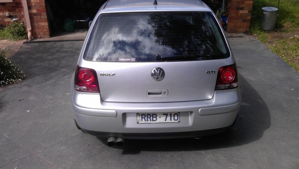

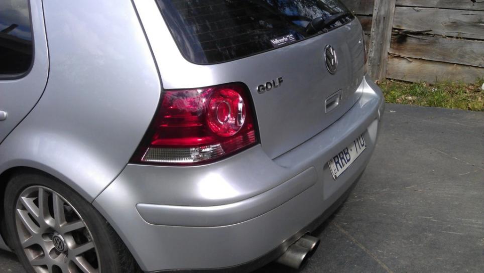

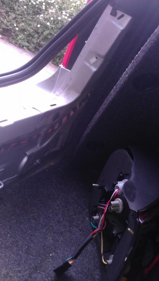

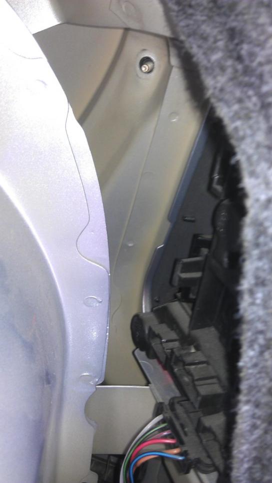

                        got around to putting the taillights in. really like how they look...
                        i removed the center trim as i thought I was going to have to swap some wiring due to being LHD taillights.
                        3 screws to remove each taillight. nice and easy, just dont drop the nut.

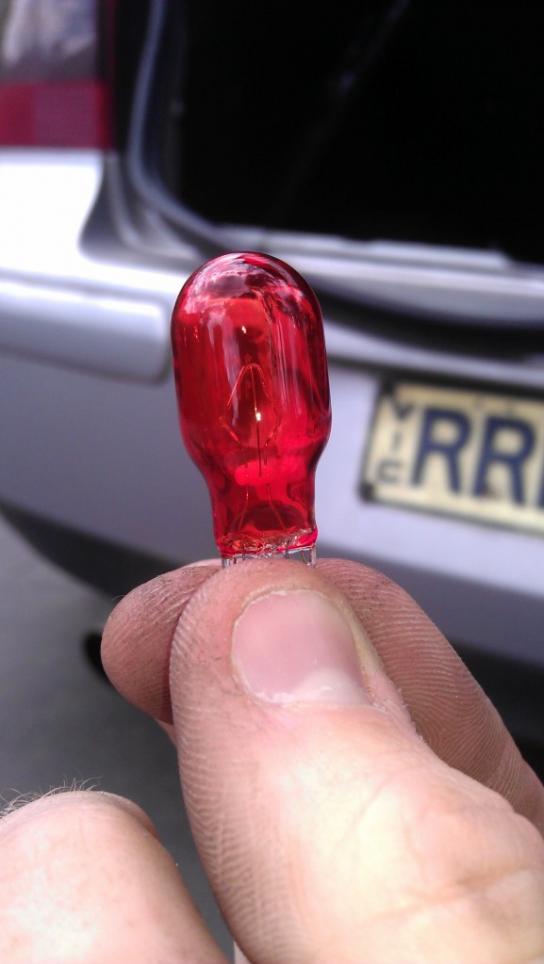

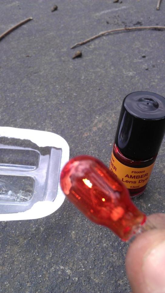

                        there were 5w t5 lights included, which obviously meant the indicators flashed like crazy. So i bought some 16W t5's and then had to dye them (just like putting on nail polish).
                        a few more coats, and viola!
                        OEM vs hybrid mk4/5
                        the finished product
                        Ill get some shots when its dark too.
