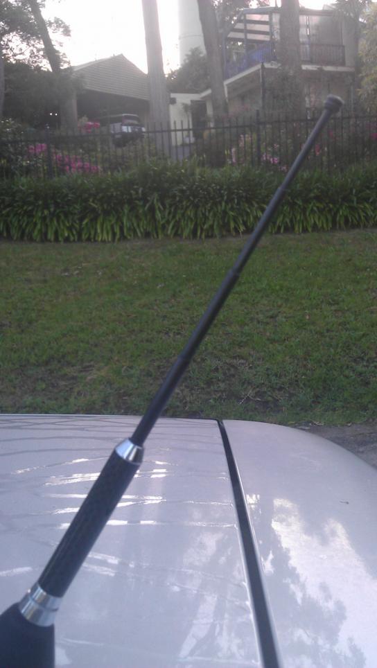

                heres the extendable CF antenna i ordered from ECS.
                its pretty cool and gives slightly better reception than the sharam stubby i had before. I think ill still buy an FM booster though.

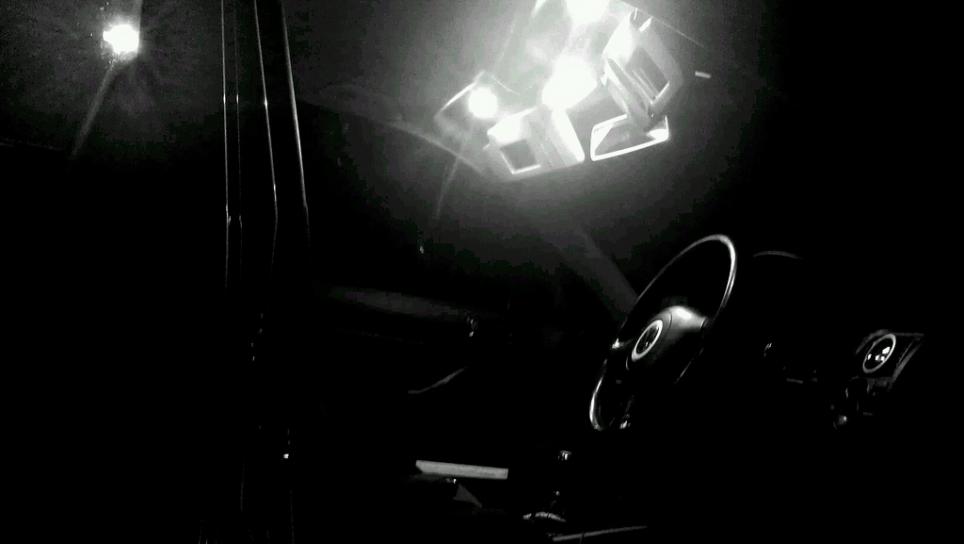

                heres a pretty average shot of the tunerdome LEDs i installed, its like impossible to show how much they brighten the car, so i made it black and white just to be artistic.
                I guess youll just have to trust me that they are worth 100$.

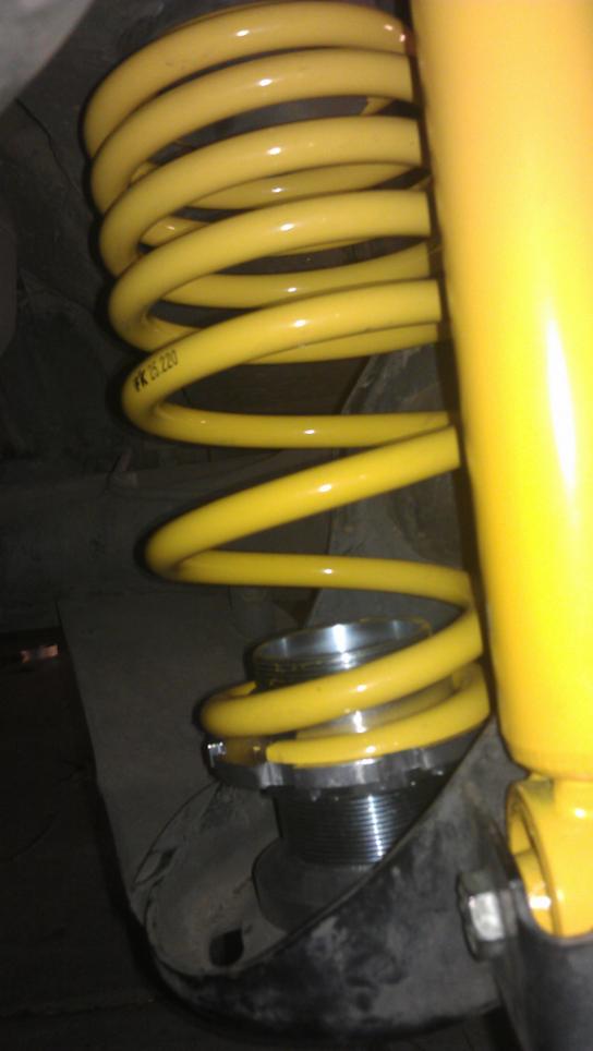

                And friday night i chucked the rear FK coilovers in. Wanted to get the fronts in as well, but the girlfriend chewed up my weekend. All good.
                Going to re-adjust them today though, sitting too high currently. Pics of the car once the fronts are done.
