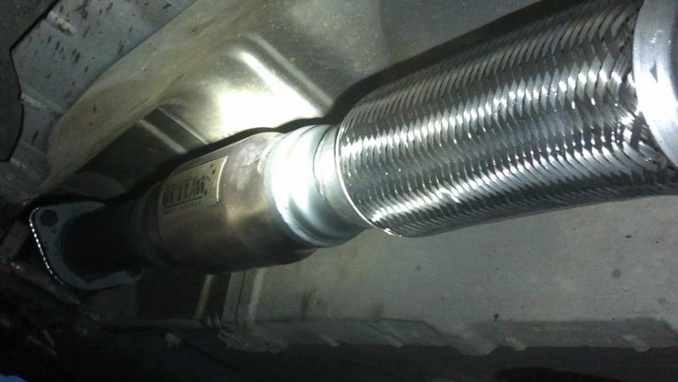

        The GTI now sports a viezu race tune, and a 2.5 inch stainless steel dump pipe with flex pipe and 100cell race cat, which matches up to my existing billyboat stainless catback system.
        Car definately has some more pull, but being 40 degrees the car wasnt exactly in prime running weather, so i didnt give it a good go. They got it up on the dyno, but said it was too bloody hot in the dyno room to get anything of an accurate run and the timing was getting thrown out.
        Ive gained around 5 PSI from the tune i'd say, though im fairly confident i have a boost leak, which i was under the impression i had earlier. The car just isnt holding boost very well. It will peak at 4K rpm and then just start to drop away.
        Im going to get the system pressure tested and ill make an opinion of the tune once a few tanks of fuel and any errors have been rectified.
        I must say, it sounds awesome.

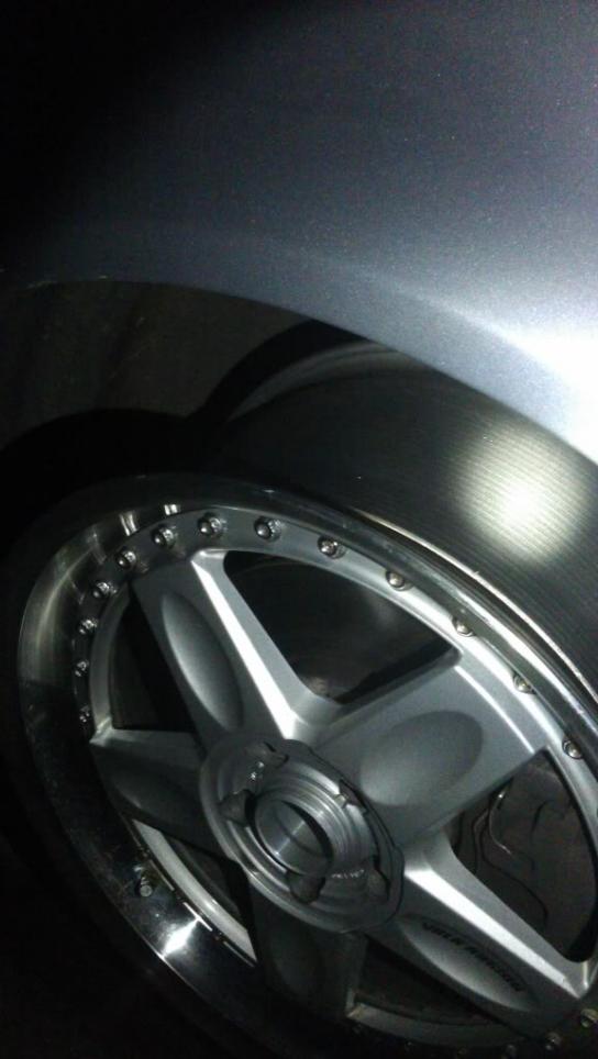

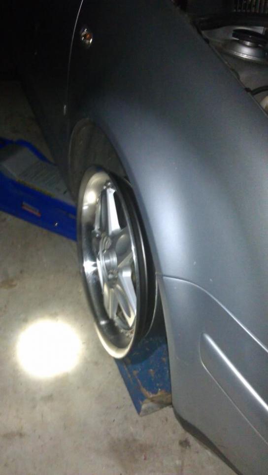

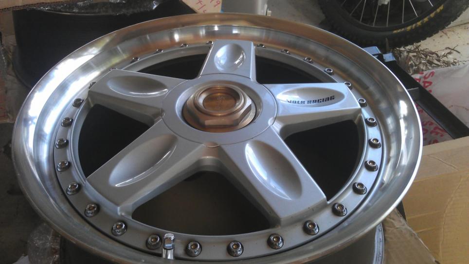

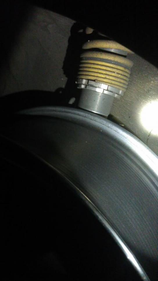

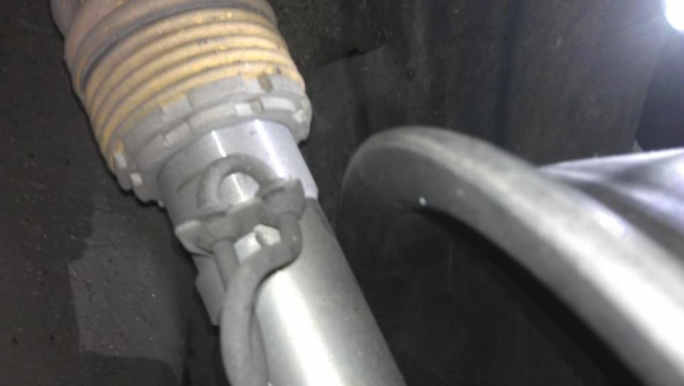

        then whilst i had my car back, i decided to test fit the volks on the front.. 17x8 +38 (the other pair are +39, but i tried the 38s on the front)
        Think i might need spacers?

              Heaps of room man, only need like 2mm and your good
              get rid of the helpers if you want more space for tyres

                sweet, was waiting for your reply dyl.
                Drilling worked out sweet. fitted the volks up no problem (obviously still need hub rings), so took a little effort getting to line with the PCD

                      • Looks good mate, I had the same issues with my wheels/FK AK's. I removed helpers and put spacers on. I also had to remove sway bar as the driveshaft was rubbing hard on it!
