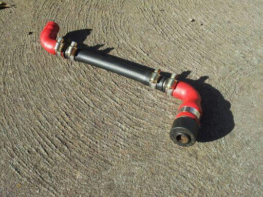

        • #19
          Well I've fixed the noise for the moment.
          First I replaced all the vac lines with fuel line and screw type hose clamps, dv working as it should again.
          Second I made a new pipe to replace the split one, check it out, its temporary for now, bursons didn't have any brass right angle hose joiners, so I've made do with this.
          When I get a new pcv valve ill remake it again.
          Cars booked in for Monday to get scanned and a few things looked at but at least for now the noise is gone.
