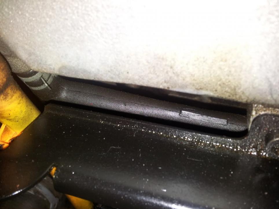

            Still been having problems with this, and i think i maybe on the right track.
            Pcv and/or fpr
            I noticed a big drop of vac on the weekend down to about 18 at idle was about 22 (hg), so replaced all the small vac hoses from the manifold and fpr then noticed this (see pic)
            Just above the rectangular shape on the hose is a large split, I've tempory used some high pressure silicone tape to cover it till i replace it. Vac came back to 20 but after further playing and listening i can hear air coming from the fpr.
            What would i do to fix a leak from the fpr??
            Also what should the normal vac readings should be??

              22 is about bang on for vac mate. where on the FPR is it leaking?
              '02 GTI (clicky) - REFLEX SILVER - VIEZU race tune. VAR design 2.5inch stainless steel dump pipe with 100cell cat into 2.5" billyboat stainless cat back, Forge TIP, N75, Audi DV, ghetto CAI, FK-AK s coilovers, tunerdone LEDs, Clarion CZ301E sound stage.
                The edge where is sits in the fuel rail (sorry i think that's how to explain it)
                      Pcv and/or fpr
                      That hose is a common problem now . It splits causing air leaks/boost leaks . Its not cheap to fix about $80 from a dealer

                        Cracked Pcv hoses near the intake mani are a common issue on your car from what I've seen. If you can't find much on here, check the 1.8t section on vortex.
                          Cool ill look into these things, another thing I've noticed is I'm not getting the same dv sound anymore if any sound at all, could this also cause this spool noise, it's a Apr r1 dv and is meant to be matinance free. I'll recherche k and try my old dv tonight to check its a dual port so I should be able to hear it release presure.
                          I've replaced and triple checked all hoses from and to the turbo.
                          Also does anyone know the part number for that cracked hose?
                          Also I do have 21hg of vac once the car is warm at start up its 18hg
