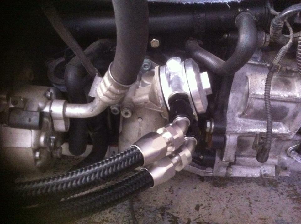

                  • Managed to get my new Oil cooler all mounted up over the weekend. Was difficult to find a position where it would receive sufficient airflow, but I'm pretty happy with how it turned out. A quick lick of paint and you wouldn't even know it was there!
                    Mocal 19 row with VR6 thermostatic sandwich plate

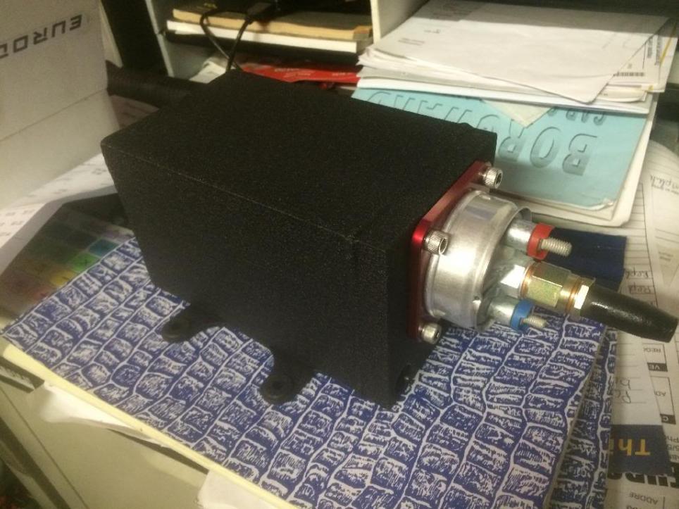

                    Also a quick picture of the Intergrated Engineering surge tank and 044 fuel pump that I will be using.

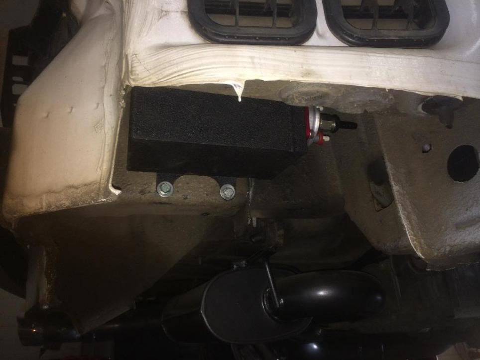

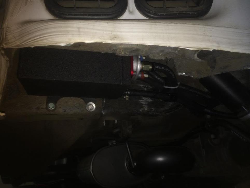

                        • Actually had a busy weekend on the car. Ended up mounting the IE tank behind the rear drivers wheel. Had to cut a fair bit of metal out (which actually sent me to the emergency ward today, to get it out of my eye!) Running 4 new fuel lines sucked too! Fuel tank feed to surge tank, 044 pump feed to fuel rail, fuel rail return to surge tank, surge tank overflow to fuel tank.

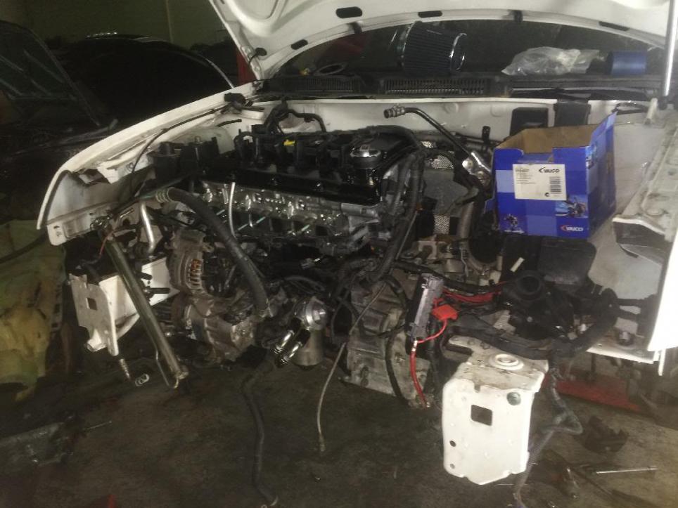

                          Gearbox had to come back out as there was an issue with the bottom timing cog. Managed to get the gearbox out, time the engine, and put the gearbox in within a couple of hours. Bolted the exhaust manifold and turbo on properly and started putting other small parts on the engine. Seb and I didn't get to bed until 4am, so thanks to him for staying up to help!
                          IE tank mounted with nutserts (prior body clearancing)
                          Post clearancing an fuel lines.

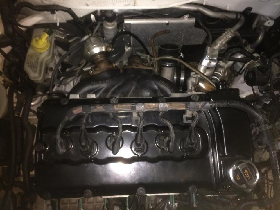

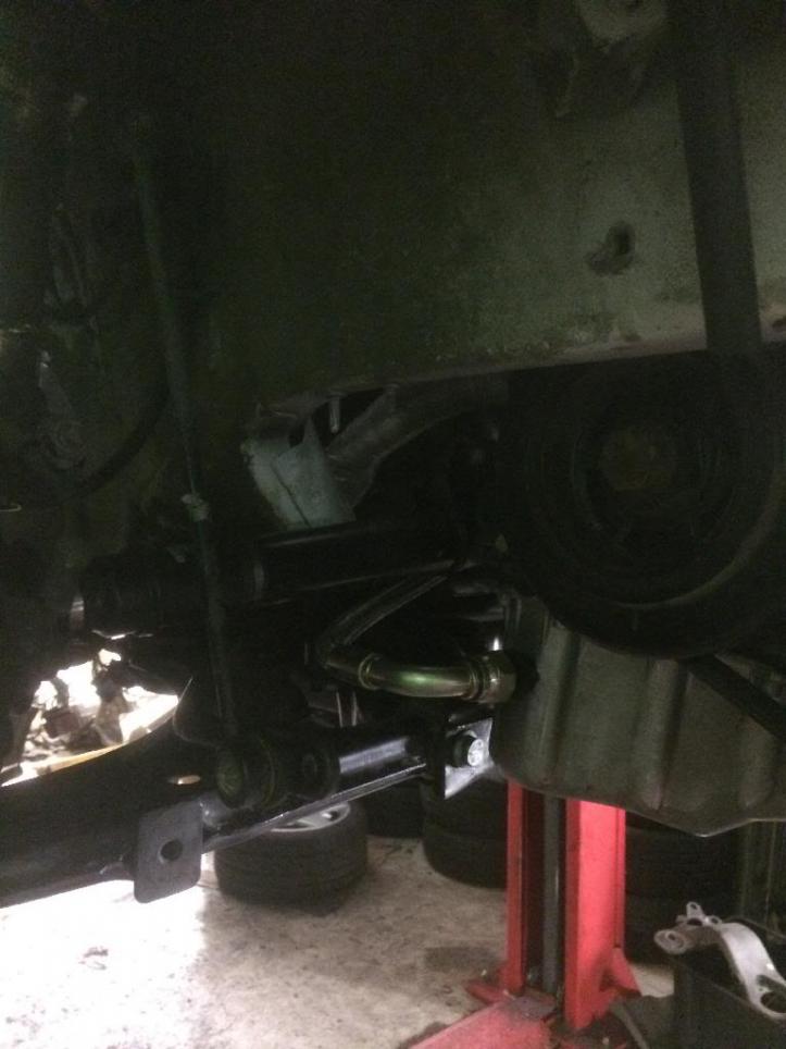

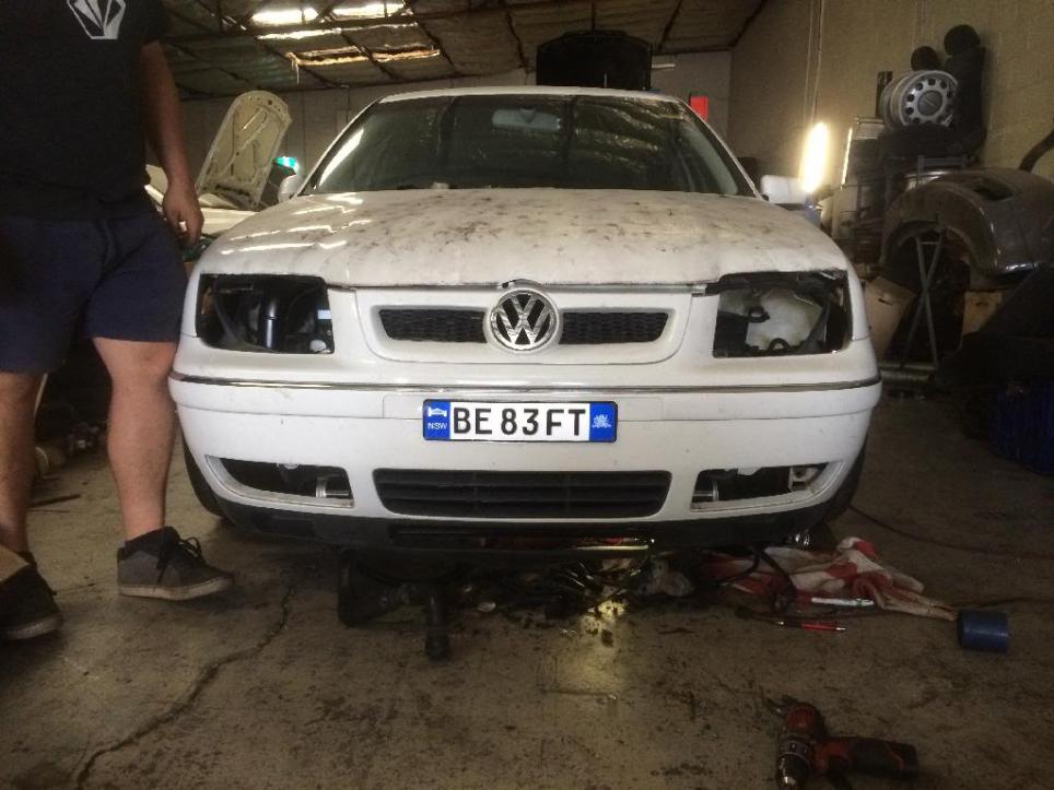

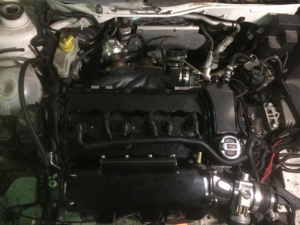

                            • Sump drilled and tapped. Sump refitted. Oil return line fitted up. Downpipe bolted up and wastegate bolted up. o2 sensors fitted. Driveshafts bolted up. Steering rack bolted to subframe. Subframe bolted up. Dogbone mount fitted. Various wires wrapped in conduit. Injectors fitted to fuel rail. New connectors soldered onto injector harness. Fuel rail and injectors fitted. Intake manifold fitted (may still need to have a play with this)
