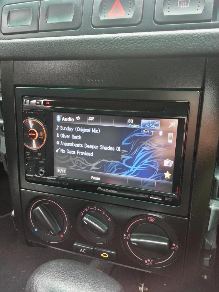

  • recently just finished mine too, i used a vinyl spray and it kinda gave a glossy look, i was keen for a matte finish too but rather happy with the way it turned out, here are some pics

      • wanted to do mine black like above, looks good!
        feel like the finish will handle being bumped and scuffed on places like the door handles?

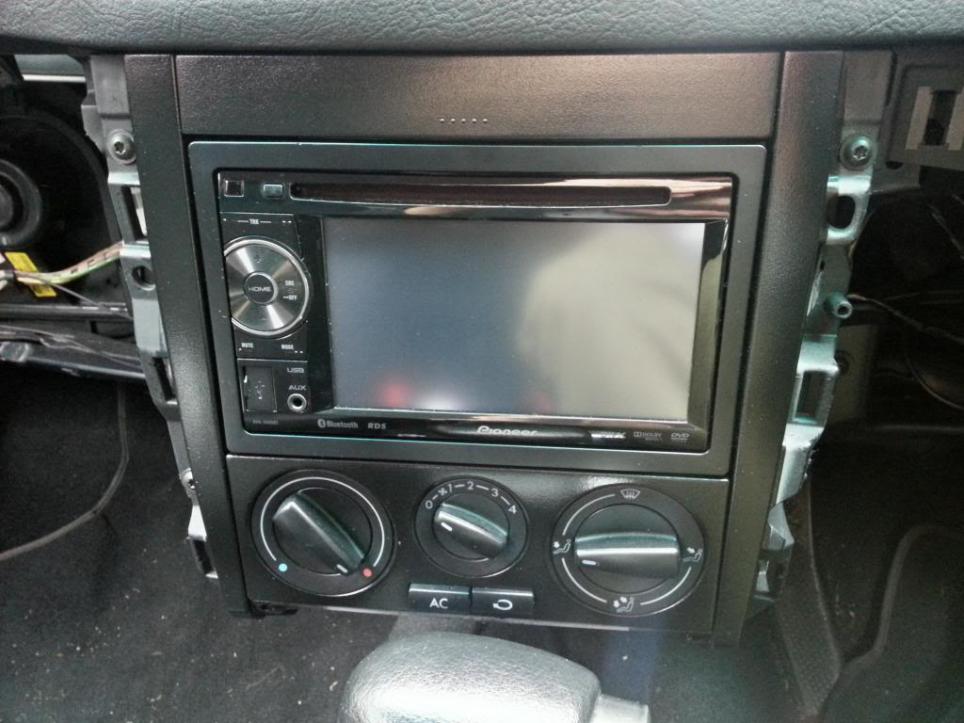

        • Here's my glovebox after painting ...
            I've done the front handles and they're holding up well, no marks or anything yet just dust is really visible on the surface
            Looks just like new! is that the Krylon flat black?
            • Originally posted by kdog View Post
              Yes - Krylon flat black (NOT matte black as I said previously) ... It's a very close match to OEM and seems to bond really well to the plastic.
