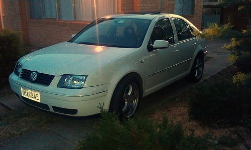

                    • Got my Bora back today after a month at the diff doctor.
                      Tomorrow it will get a good wash and some goodies installed that have been sitting in my shed patiently waiting to go
                      You can't see it so well in the pic but it is covered in a thick layer of dust
