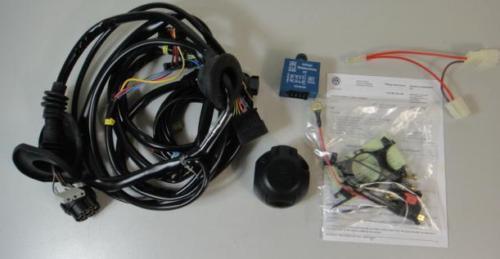

                    • Agree Gavin.
                      Bought a couple of things today
